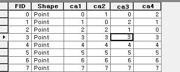

I am trying to switch numbers between rows
here is the thing
there are 8! (40320) cases that i need to make arraying numbers in total
E.g., (8*7*6*5*4*3*2*1) : (0, 1, 2, 3, 4, 5, 6, 7) (1,0,2,3,4,5,6,7)(1,2,0,3,4,5,6,7) (1,2,3,0,4,5,6,7) .... (7,6,5,4,3,2,1,0)
so i am going to create 40320 fields and trying to put number in it.
I was thinking that i could use Random number generator but it returns duplicate number in rows and also it might have a chance to have duplicate fields.
Are there any ways that i can do this easy way using field calculator's code block?

yeah, i agree with that a table with 40K or more fields is crazy .. but i think that's the best way to find out the best (shortest path) route between 8 points -(calculating all the possible route and find the minimum distance among all)
if you have any advice on this, please let me know

I am applying Dan's solution to this
