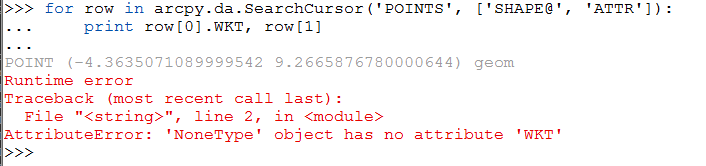

Although, its possible to store both together, there are some issues that you may experience, such as errors in analysis stating the operation was performed on an empty geometry or in Python, the null geometry will be returned as a Nonetype.
Simply put, all a non-spatial record represents to the geodatabase is a NULL record (except for in SDE). As long as you are aware that those records are there and the potential issues or errors you may encounter, it should not damage the geodatabase on the existence of null geometry records alone.
