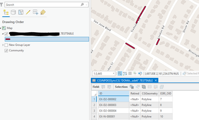

I have similar data in a SQL Server EGDB and when I drag the table onto my map in Pro 2.8.5 I do see the lines.
I know that's not helpful, but it points to an implication that it can work and we can find a solution.

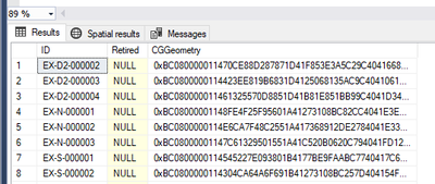

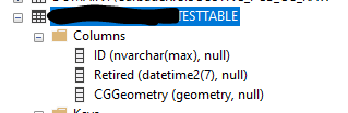

If you open the table in SQL Server, what data type is your geometry being stored in?
When you right click the table in your Catalog pane and click properties what does it show for Geometry Type and Storage:
