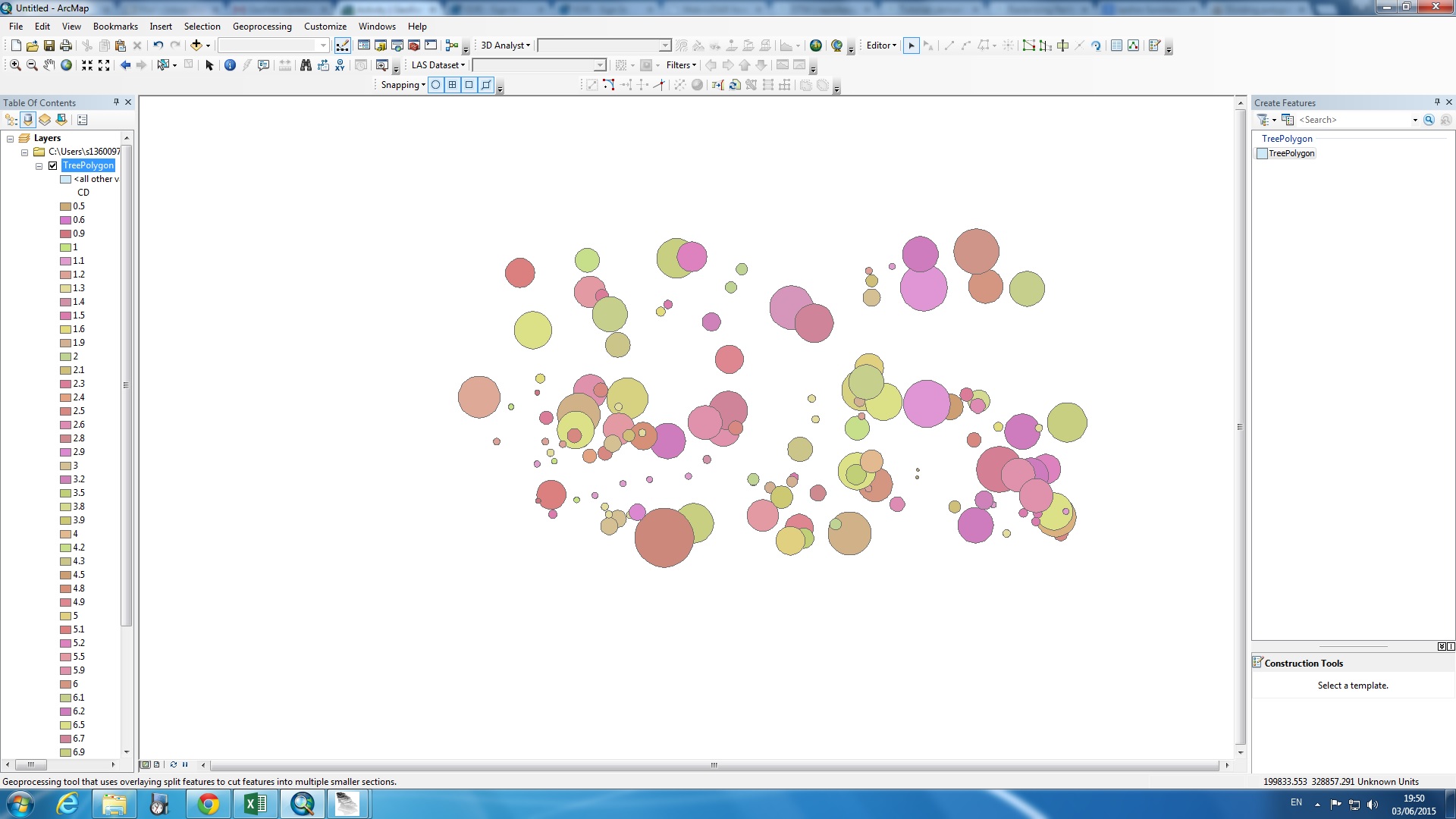

Hi,
Does anyone know how to split this one shapefile into one single polygon based on each value of attributes. I have this polygon layer but with many attributes, like for example this one below is based on tree crown diameter size, the rest is like tree height etc. So right now i want to split it into individual tree polygon based on attribute crown size. Can anyone help me to solve this puzzle?
Thank you in advance!!

SepheFox
Deactivated User
I'm not certain I understand your question. Are you saying you want the polygons in this shapefile to become individual shapefiles, with each shapefile containing features with the same diameter size? If so, may I ask what is the purpose of doing that?

Yes you get it right, i want all the polygon to become an individual
shapefiles. The polygon represent individual tree. I need to split it in
order to clip it with LiDAR point cloud data.

Thank you for your answer. The aim of this exercise is not to give a height for each tree, my tree plot study area is come from a dense intermingle crown tropical forest. So i want to generate an individual tree modelling. Right now i want to separate each of the polygon (crown) to clip with lidar point cloud. I managed to clip it using FUSION software, but because of the intermingle crowns (overlapped polygon) 18 of the tree plot are missed to clip. So that is why im looking for an alternative to split the polygon.
