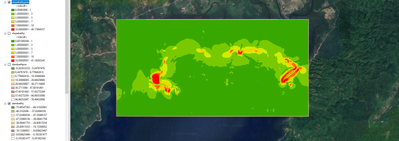

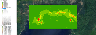

MShairah
Hello Dan,
Thank you for your response. I've done as you suggested and these are the results. The green areas (low slope) are more or less the same for both rasters. However , the red areas (slope values greater than 10) are more pronounced and cover a bigger area when using the absolute value of the depths. I wonder why this is so.....
DanPatterson
MVP Esteemed Contributor
Your mins and maxs are different.  check that your raster properties were the same eg. raster type, cell size, alignment etc were the same and you may have to fine-tune your classification.
Also, subtract the two ... that is where you will see the differences and their magnitude
