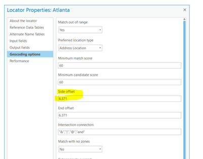

IanMackenzie
FYI.   Display Options including side offset will disappear when you disable   "Street Address" as a geocoding match option (Geocoding options >> Match Options >> Categories to support).  This is something you might do, for example, if you only want that particular locator to work for reverse geocoding within a composite locator.  Even though the display option is inaccessible the offset still applies when you reverse geocode (point will jump the set distance to side of line when you click on map).  If you want to set the offset you need to do this before you turn off the match option.  In my case I wanted the point to remain on the line as I am only using this "sub"locator to return the street name on a reverse geocode.  So I set the offset to 0 and then changed the match options. This is the case as recently as v 3.0.
