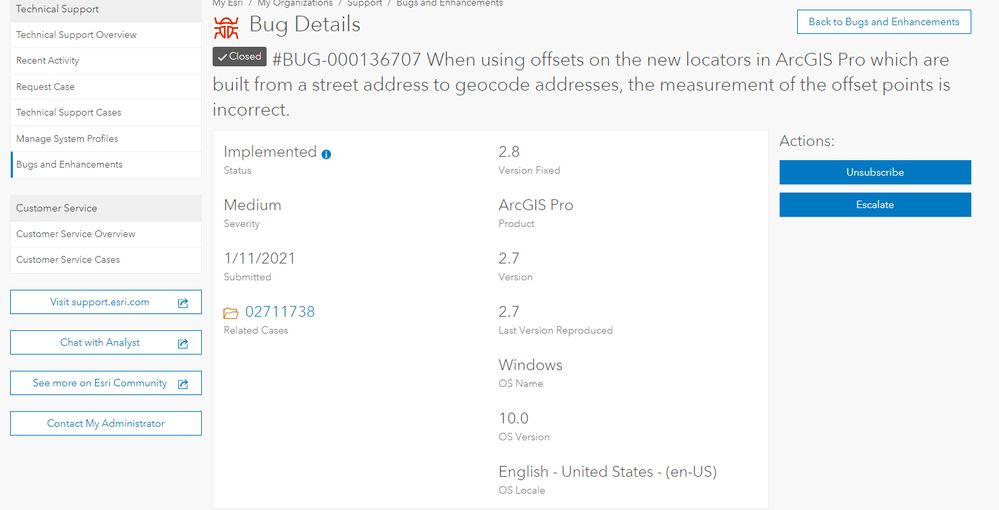

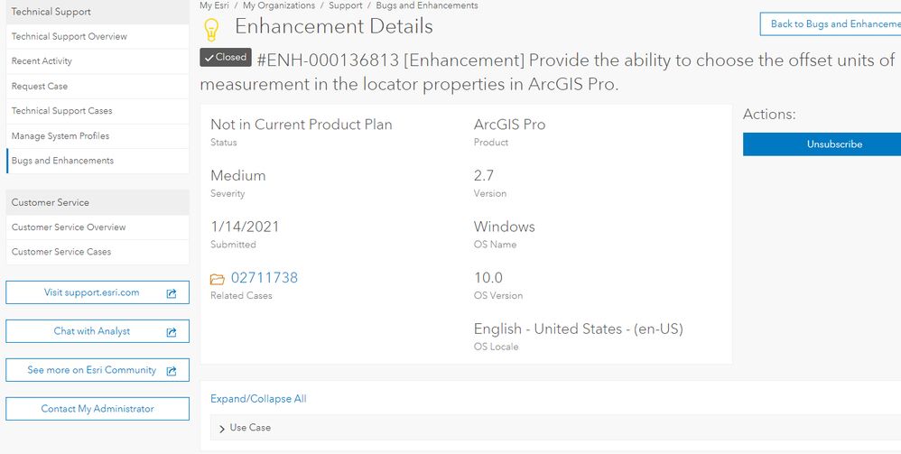

I hope you can see from these clips, that ESRI is aware of these problems, and is working on it.
and whenever Pro 2.8 comes out we'll take another look at switching from our ArcGIS 10.x Geocoder to the create Locators of ArcGIS Pro.
Brian

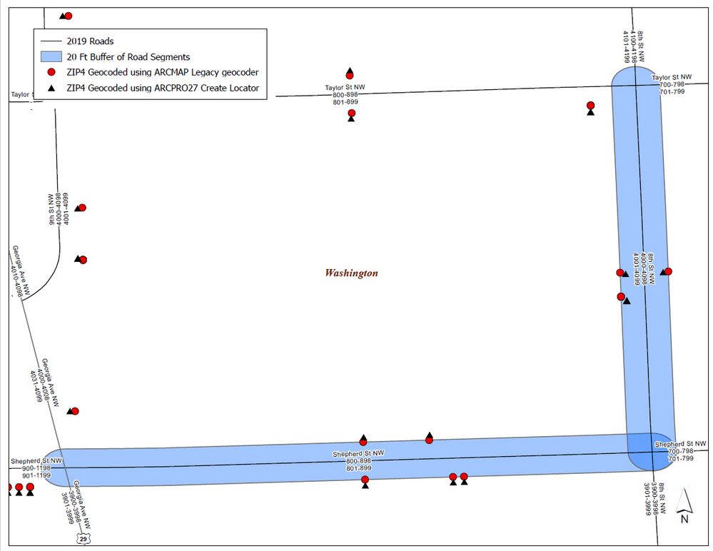

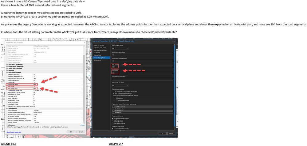

In my case 20ft wasn't 20ft when coming out of the create locator (Pro2.7), the east west distance was diferent than north south, as you can see the fix is said to in Pro 2.8, Holding breath!!In my case 20ft wasn't 20ft when coming out of the create locator (Pro2.7), the east west distance was diferent than north south, as you can see the fix is said to in Pro 2.8, Holding breath!!The ability to choose which distance type ie feet, meters, miles etc. are not an option that could be selected from a pulldown menuThe ability to choose which distance type ie feet, meters, miles etc. are not an option that could be selected from a pulldown menuIn both ArcGIS 10.x and pre Pro2.7 "Legacy" coders, you could set these parameters.In both ArcGIS 10.x and pre Pro2.7 "Legacy" coders, you could set these parameters.20ft used to be 20ft no matter the Axis.20ft used to be 20ft no matter the Axis.
