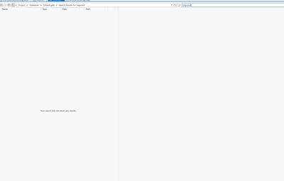

Yes, this is exactly what is not working for me.
Searching for this specific file by tag:
I search, (and directly in its database, too) and nothing pops up.
I am using Pro 2.7, and I can't figure out why this won't work.

Yes, as you can see in the second photo, that is exactly what I did.
