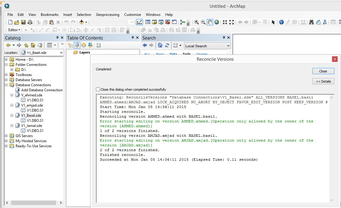

I have the versions structure shown in the screenshot below:
I wanted to reconcile between Basil and Ahmed + Amjad.
I got the error below”
Error starting editing on version AHMED.ahmed.[Operation only allowed by the owner of the version [AHMED.ahmed]]”

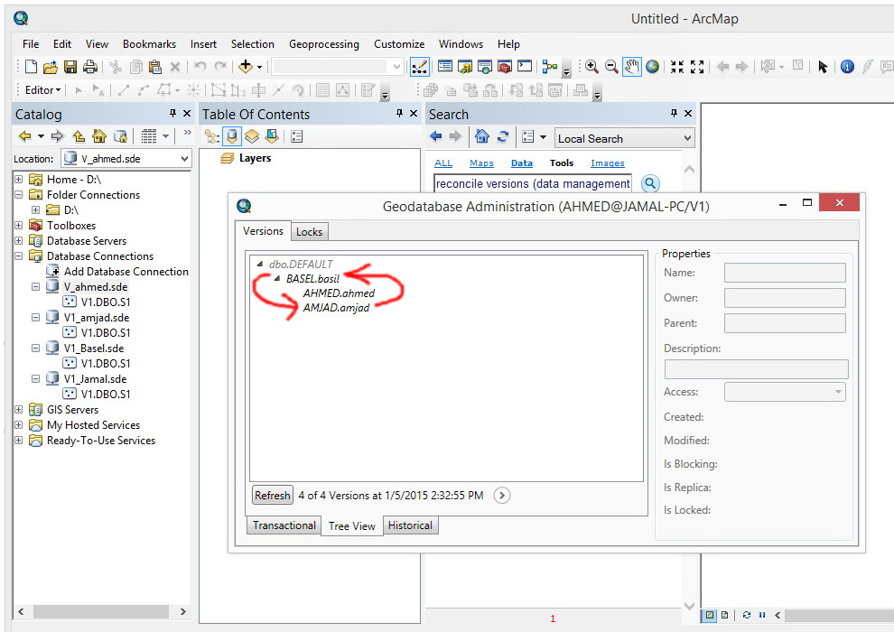

What user are you connected to the database as when you are running the Reconcile Versions tool?  Also, what is the 'Access' set to for each version? i.e. Public, Protected, or Private?  You can check this by right-clicking on the database connection > Administration > Administer Database > Versions tab.

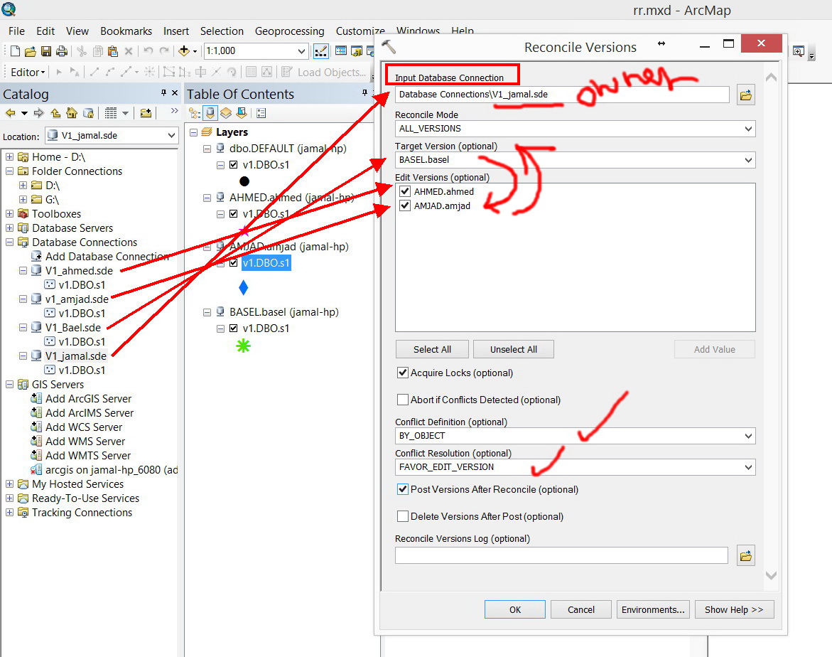

Many thanks Jake for
the answer,
I have filled the “input database connection” with the owner and then the “reconcile version” tool works
fine.

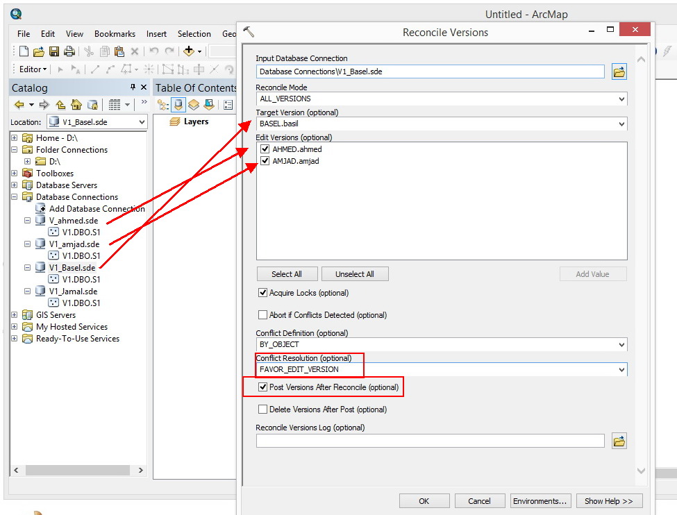

In case the “input database connection” is filled with a user, “reconcile version” tool introduces the editing error below (as shown in the screenshots posted above)
What does this signify for?
The access type of all versions is “protected”
The owner of the V1 database is jamal

Unless the user has 'db_owner' privileges (or sysadmin), the user will not be able to reconcile a version they do not own, unless it's Access is set to 'Public'.
