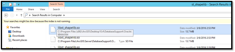

2) So, we copied the libst_shapelib.so file (as shown below) from our dearly Windows Server where the ArcSDE is installed,
3) We pasted the above file to our precise Linux database server.

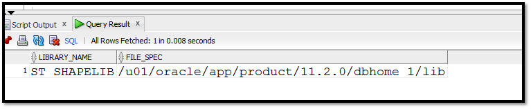

9) We checked the library and its path for the SDE user for confirmation. We got the following results:

Thanks for your feedback. We overlooked some details. We pointed the full path with the file name for ST_SHAPELIB file. Also, as per the other thread, we ran the following code to grant some privileges to the SDE user .
 i.As sys user, grant execute on SYS.UTL_RECOMP TO SDE. SQL> GRANT EXECUTE ON SYS.UTL_RECOMP TO SDE;
          ii.As SDE user, recompile. SQL> EXECUTE sys.utl_recomp.recomp_serial('SDE');
We did the above changes and the sample script is now working but add/deletes SQL script posted on GITHUB - developer-support/delta-table-record-count.sql at master · Esri/developer-support · GitHub  has issue parsing XML. Need to dig into that issue now.
