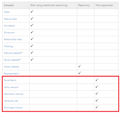

I'm in the process of upgrading all of our automated data maintenance Python scripts from 2.7 to 3.x. In our current setup, we have two cases where the parent SDE GDB has a geometric network in one more more dataset, but the child replicas do not. Syncing works fine in 2.7, but in 3.x, I get the following error message:
ERROR 003131: Replicas containing geometric networks, parcel fabrics, or cadastral fabrics are not supported
Has anyone else had an issue using arcpy.management.SynchronizeChanges on an existing replica when running the tool in Python 3?

Description
Some data types are not supported for replication. The data in Geodatabase 1 includes one of the following unsupported types: geometric network, parcel fabric, or cadastral fabric.
Solution
Remove the unsupported dataset and create the replica again.

"Geometric networks are read-only and are not supported in a replica created in ArcGIS Pro; this includes any feature classes that participate within the geometric network."
ArcGIS Desktop (ArcMap & ArcCatalog) Geometric Network is deprecated in ArcGIS Pro and customers need to migrate from the Geometric Network to ArcGIS Pro Trace Networks (Network Datasets) or ArcGIS Pro Utility Network.

ArcGIS Pro 2.7 - Replication with advanced geodatabase datasets
ArcGIS Pro 2.7 Replication and geodatabase compatibility
