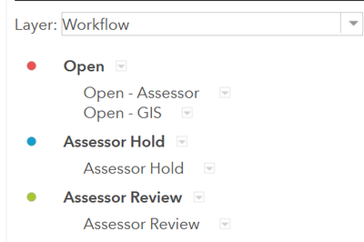

That said, you can sort of replicate subtypes by carefully managing the editing templates that are available for the layer. For instance, I have a layer for a document workflow, and I want to treat the "status" attribute as a subtype.
If a user adds an "Open" type feature, the two available templates restrict the "department" value to Assessor or GIS, and defaults other fields to certain values as well.

Then on each view layer, define editing templates restricted to the various values allowed for that subtype.
It's not exactly the same as the true subtype functionality, but with a web-hosted layer, it may be the best you can do.
