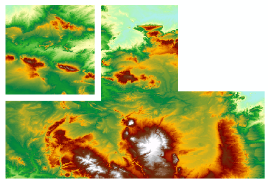

I'm attempting to combine 5 1x1degree Wyoming DEMs from the USGS database.  Ultimately, I need to create a custom DEM for a southern rockies study area to use for my project.  My most successful attempt has been using the mosaic to new raster function, but the result has a blank area that shouldn't be there.  I'm pretty new to working with rasters, so I'm not sure where I'm going wrong. I did try out other mosaic operators (blend and mean) but using those made the blank areas larger.
My attempt:

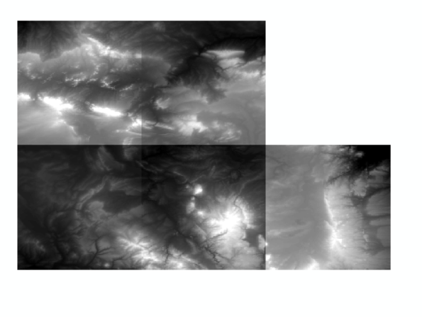

The original rasters:

If the white band is being caused by one of the rasters having a band of NoData at its margin (presumably the raster in the NW), maybe before the mosaic operation you need to clip that raster to include only the portion that you need (i.e. get rid of the NoData).

Although I haven't discovered the cause of the white spaces in my mosaic, I did find a workaround.  I combined the two rasters that were being finicky (bottom left and upper right).  I then mosaic-ed that new dataset back to the dataset of 5 with the white spaces.  This new data set has all its data visible and is mosaic-ed correctly.
