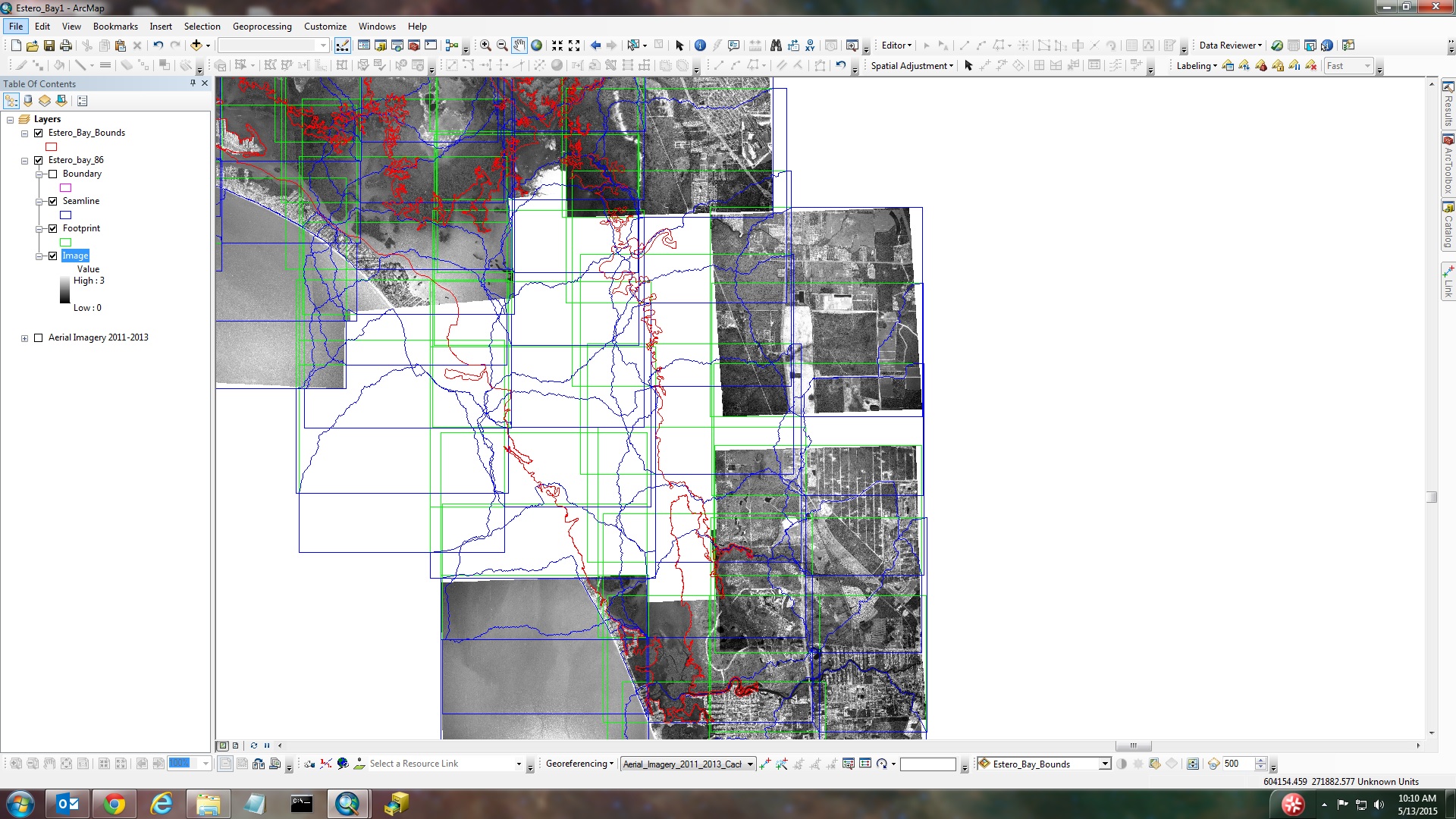

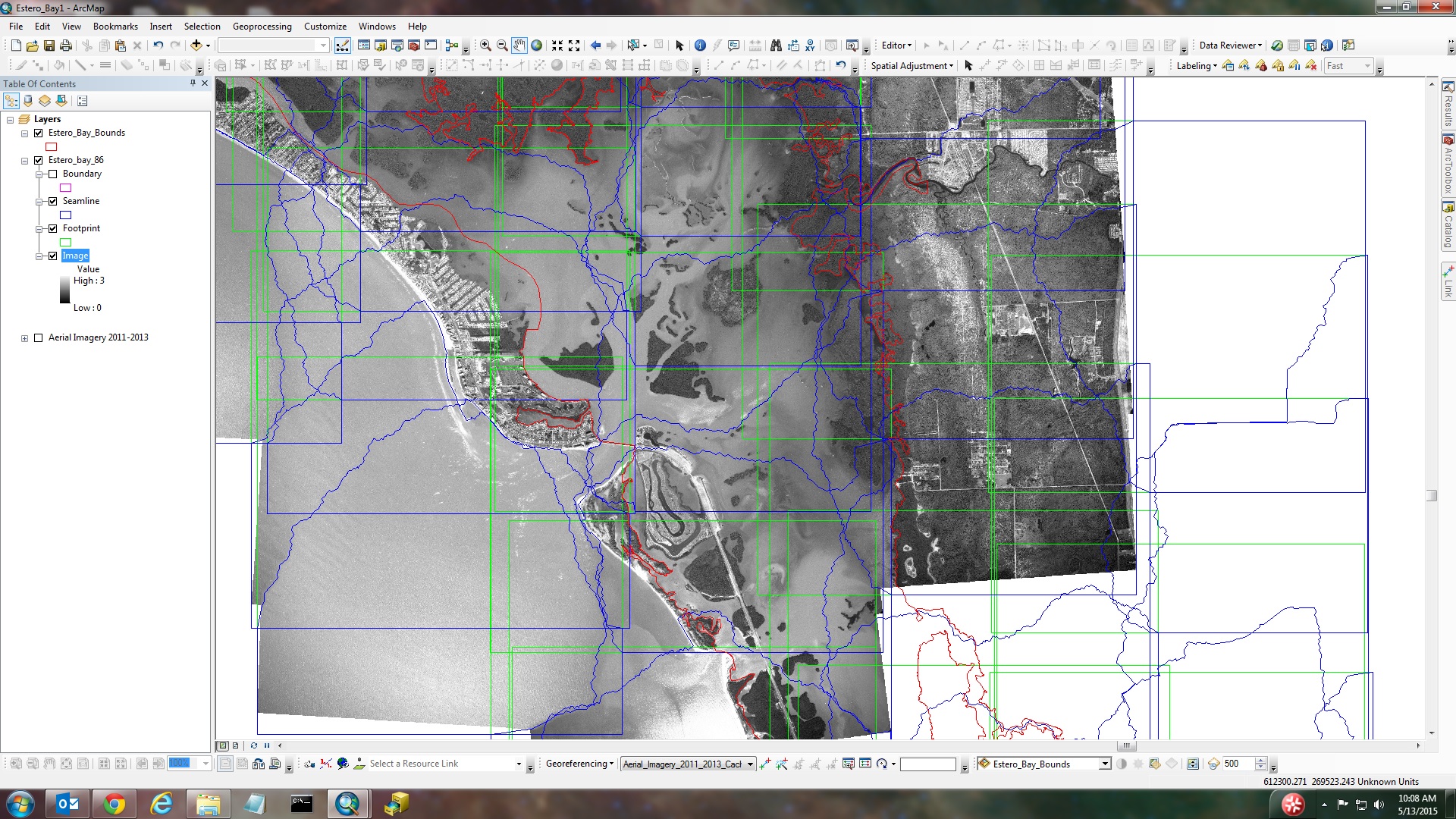

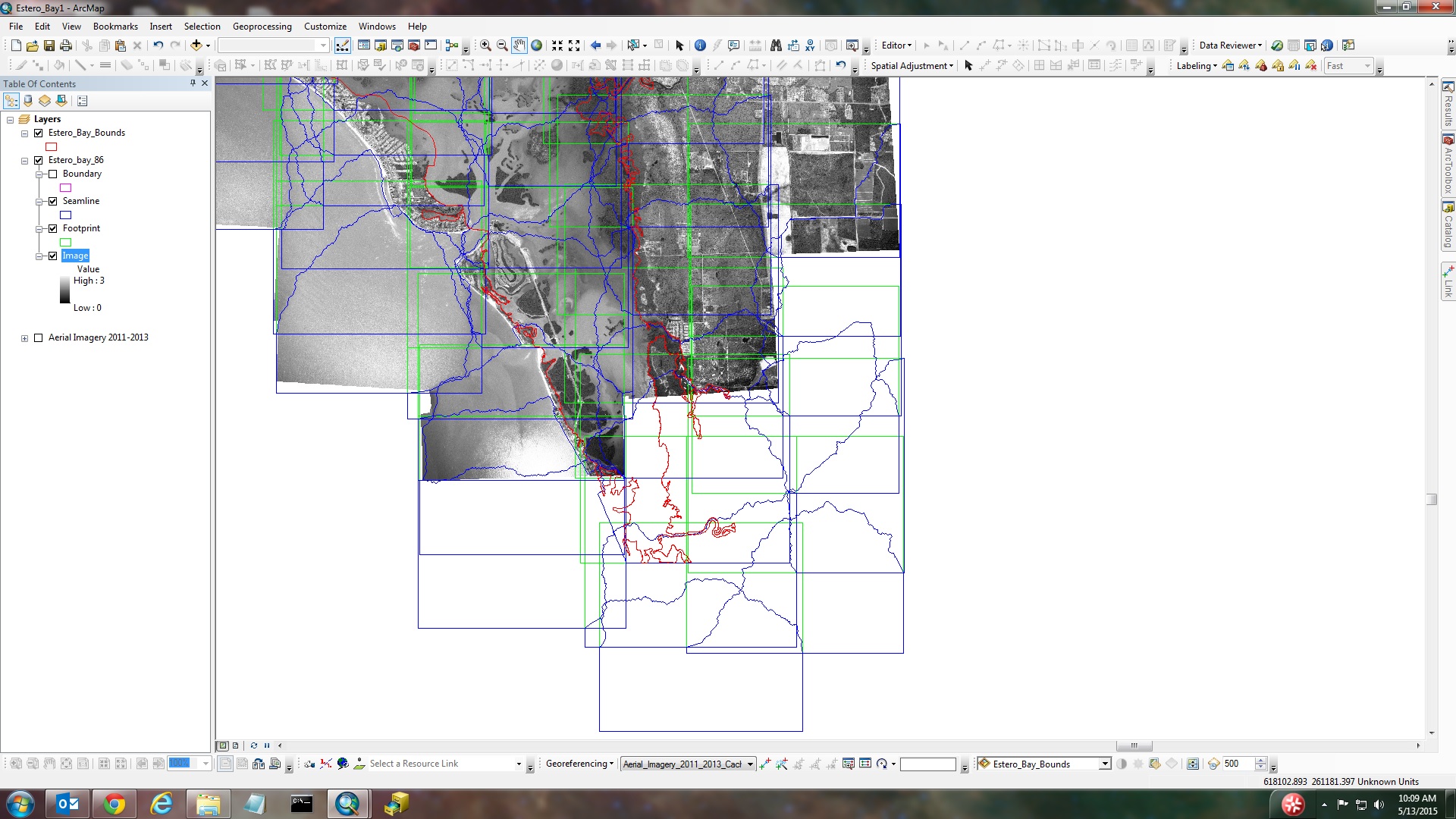

Here are a few screenshots the first two are when the method is along seamlines and blend, the last is closest to center and blend. Seamlines.jpg

I am happy to assist if I can.  Mosaic datasets can be pretty complex beasts so this may take some back and forth.  I am pondering the possibilities based on the current info but after reviewing the screenshots, they all seem to suspiciously be displaying ~20 datasets.  I know you mentioned adjusting the "Maximum number per mosaic"  setting but can you verify the setting is actually set to 50 and also that you have removed and re-added the mosaic dataset to ArcMap?  This is worth double-checking before we delve into the other possibilities.
