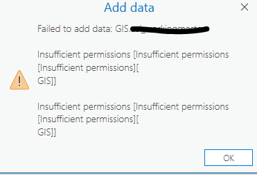

AndreaB_
Hi @George_Thompson , @MarceloMarques
I followed the permissions you stated. However, now when I try to add the data as the sde user I get:
SDE must need something more? Thank you.

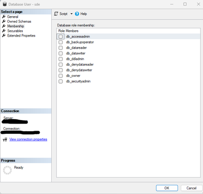

So sde isn't listed as a login to the instance.
Then under the database properties - permissions - sde: it has connect, create function, create procedure, create table, create view
Database User membership: no roles.
AndreaB_
So a couple of things I just learned in my deep dive - sde was missing the 'SELECT' permission so it couldn't add the data to ArcGIS Pro. I added 'SELECT' permission and 'sde' could add the data to Pro. I believe I could just use the db_datareader role for this also.
More interesting - I found this little nugget hidden in here: https://pro.arcgis.com/en/pro-app/latest/help/data/geodatabases/overview/grant-dataset-privileges.ht...  If the dataset is registered for traditional versioning, the geodatabase administrator must have full privileges on it. I do have traditional versioning, so I am going to assume that my 'sde' user needs 'SELECT, INSERT, UPDATE, DELETE' on all of my data. So that will bring me back around to granting 'sde' the db_datareader and db_datawriter roles.
I see some of this info on that link you gave me before,  https://pro.arcgis.com/en/pro-app/latest/help/data/geodatabases/manage-sql-server/privileges-sqlserv... but it wasn't clear to me.
I also learned from the first link above, "Grant and revoke dataset privileges in databases and enterprise geodatabases", that I could use the Privileges dialog box and the Change Privileges tool in ArcGIS Pro - how awesome! I had no idea. I see the link from one page to the other now. *Deleted the rest that was here...makes sense now...
Thanks for your help.
