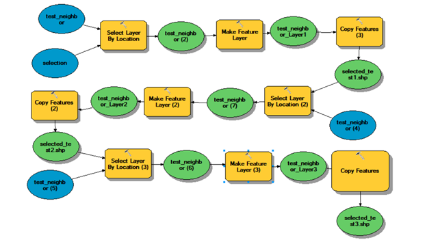

For now, I can create a 1st order-neighbor selection from the initial polygon (with Select layer by location tool) and make a feature class with it (with Make feature class and Copy feature tools).

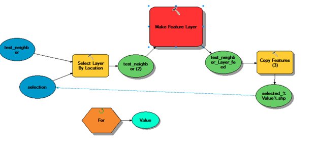

As I try to insert "For" iterations and as I try to use that 1st order-neighbor selection to create a feedback loop, I keep having different problems (only one shape is created, nothing is created, arcgis crashes).

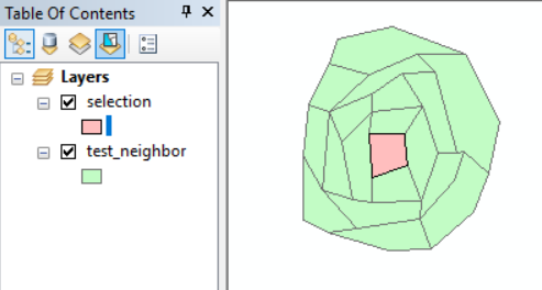

PS1: I don't mind having a separate shape as my initial polygon or simply selecting one polygon in the input feature (test_neighbor)
PS2: I'm looking for 3 iterations at least
Example of feature class I want to extract neighbors from (test_neighbor) and initial selection (selection) :

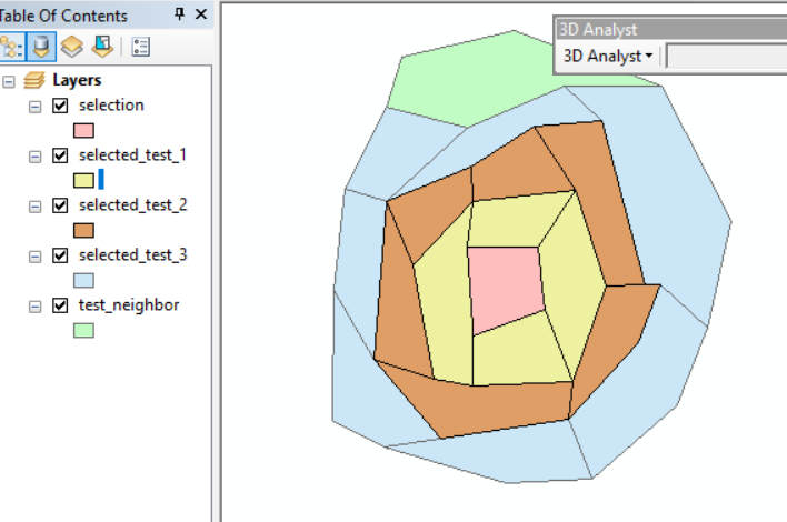

Example of working model but with no feedback, with result (on the right):
Example of model with feedback (not working):
