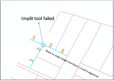

Dear All,
I have a huge data for street and but streets are in segment and there is no field on the basis of which I can merge. I use unsplit tool but it fail where two streets intersect kindly help me out to merge segments of  streets into one street. Please see the image for details.

Are you planning to use this as an input to a network dataset? If so, you'll want to keep the segments separate. The dataset didn't come with anything like a "name" field? Where is it from?

NomanJaved
I dont want in network dataset  i just want to merge these lines. there is name field but lot of street without names which causes the problem
