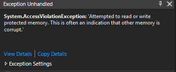

ElizabethWare1
Ok fixed the embedded error. But I do the GP.Execute and I get this error:
I have seen this with another program too and have not figured out what is causing it.
BradNiemand
Elizabeth,
I can't guarantee this will work but try disabling multithreading in the locator and see if that helps.
Brad
