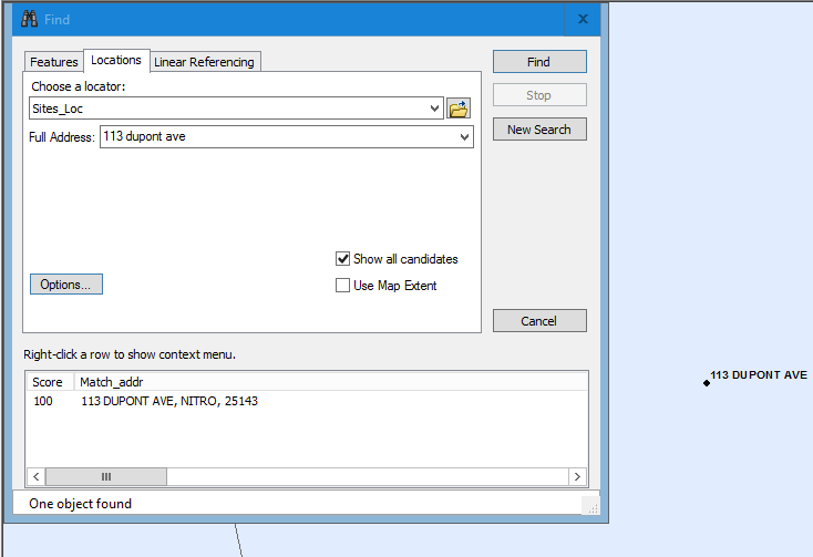

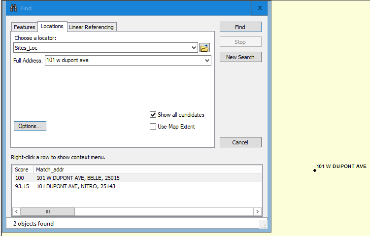

For some reason, my address point locator scores all E Dupont Ave addresses as 82.65.    I've checked all the attribution for the E Dupont Ave addresses, and everything looks fine.  I'm not sure what's causing the issue, but I need the locator to score these addresses at 100.  The W Dupont Ave and Dupont Ave addresses are scoring at 100.  Any ideas?
