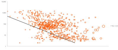

Hello,
I'm trying to use three variables at a time in a scatterplot. I chose two variables for the x and y-axis. And the third one is the size of the symbol proportional to the attribute.
Can anyone please tell me how to make a legend for the plot showing the details of axis and the size of the symbol? I'll attach the figures for reference. Thank you.
  I want to show the radius of symbol ranges in the legend. Please help.

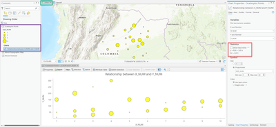

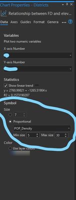

I am assuming you are trying to do this within the Scatterplot Chart in Map View using ArcGIS Pro. I do not think there is the capability to make a legend within that chart. However, I did think of a workaround for you that involves creating a layout view. Please see below:
Step 1: In map view, create scatterplot and define settings.
  • In the Contents window, define Symbology to match the desired proportional symbology (see purple box, MapView.png).
  • If the Show linear trend "legend" item is not desired, turn it off (see red box, MapView.png).
  • This is done in Map View (see green box, MapView.png)

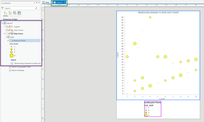

Step 2: Create a New Layout --> Insert Map Frame w/ data, Chart Frame, and Legend using Insert Ribbon
  • In Drawing Order window, only Legend and Chart Frame need to be toggled on (see purple box, LayoutView.png).
  • In the layout, arrange elements as desired (For illustration purposes, see blue border {Chart Frame} and purple border {Legend}, LayoutView.png).
  • This is done in LayoutView (see green box, LayoutView.png).
Once edited to your satisfaction, it can be printed, exported as a PDF, exported as a png --> whatever is needed for your purpose. I hope this is helpful.
