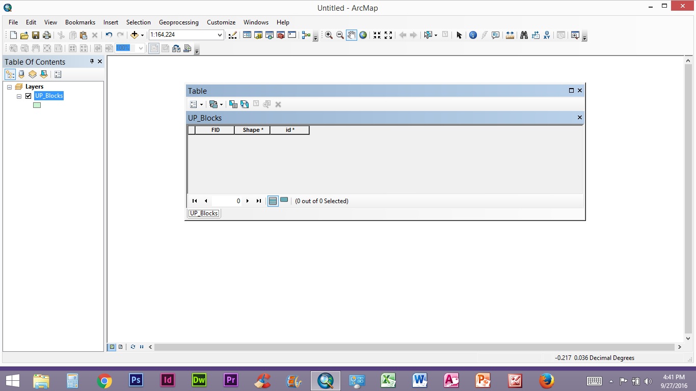

Hi,
I tried to work on the suggestions you gave, like Zoom in to the layer, but found nothing to display. I looked into the attribute table and cannot find the columns it used to show when it was installed in the previous computer.
I know it got to be something relating to the path of the files which is disturbing the layer from being displayed but I don't know where to begin in the right direction in order to solve this problem.
However, I have attached some screenshots of the attribute table, as well as the errors that display with the 'Analyze Map' from the File menu.
Spatial Properties of the layerScreenshot of Attribute tableScreenshot of the error messages with Analyze Map in File Menu
I hope this helps to look at the problem.
JayantaPoddar
MVP Alum
Thank you for the screenshots... The "UP_Blocks" layer doesn't seem to have any data (or remove the definition query, if any).
For other layers (in 3rd screenshot), validate the definition queries. They seem to be causing issues.
