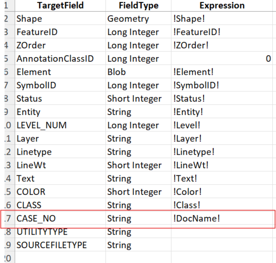

When using an expression to assign a value to a field in the Mapping worksheet, the tool fails to append the shape data.
For example, using the expression below for the CASE_NO field:

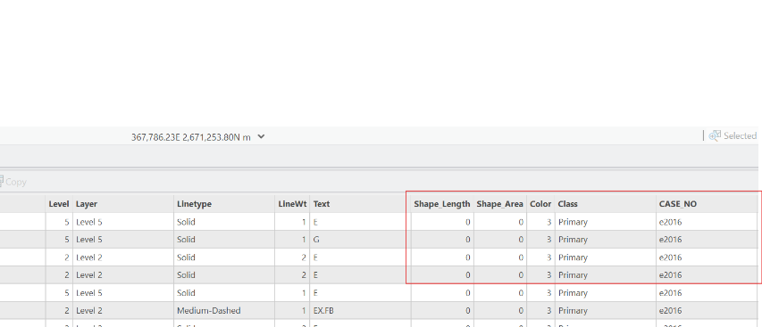

!DocName!.split(".")[0]
causes the tool to append the attribute values but not the shape. See the below screenshot:

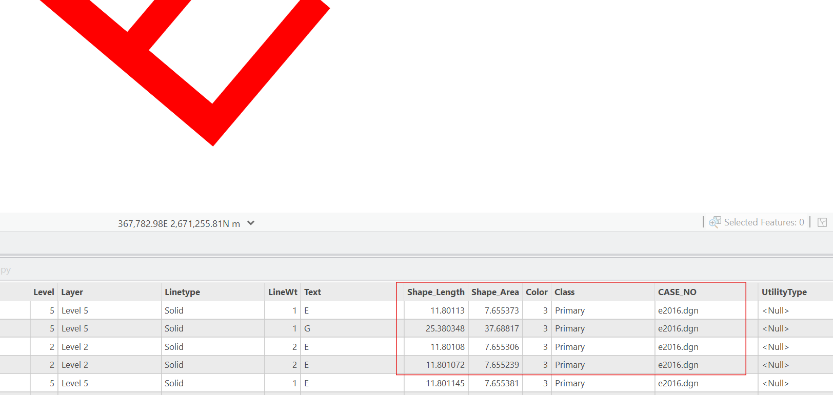

However, if I use only !DocName! (without .split(".")[0]),
the shape data is appended correctly. See the below screenshot:
This issue was not present in previous versions (such as ArcGIS Pro 3.3 and earlier), where the same expression worked correctly.

  • Synopsis: In the Load Data Using Workspace tool, When using an expression to assign a value to a field in the Mapping worksheet, the tool fails to append the Shape Length and Shape Area fields in the target attribute table with a value of 0
