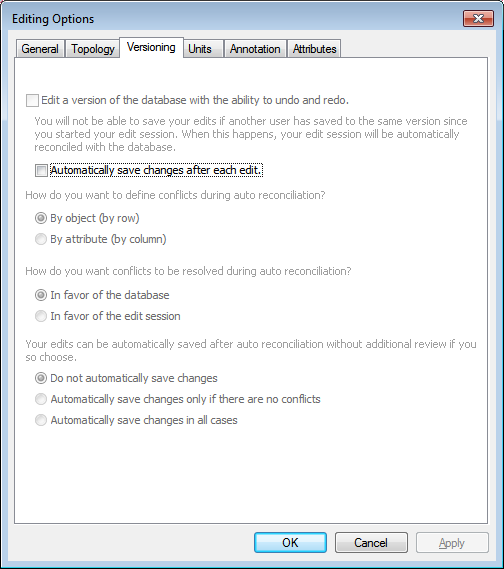

Trying to edit some content in ArcMap 10.5.1 which is coming from an Oracle Geodatabase with SDE configured and the table registered.  The table is not versioned so have turned off the versioning in editing options, and disabled the automatic save after each edit option (see below).
There is a trigger associated with the table that populates a number of fields automatically based on a key field that is populated within the edit session, and archive the record into another table if certain fields have changed.  So my understanding is that the trigger would only fire when I hit Save Edits, and yet it seems to trigger as soon as I edit the record.  Does this mean that the changes are passed back to the geodatabase as soon as I make them, but no commit is actioned until the Save Edit option is selected, or is something else going on?

I'll add, unchecking 'Automatically save changes after each edit' starts a transaction on the non versioned table when you start editing. Edits occur directly on the table without the ability to undo/redo. Triggers and stored procedures fire normally, as you may need them to maintain database integrity while you are making changes in this transaction. Nobody else should be able to see the changes you make until you commit the transaction (save edits or stop editing with save). Stop editing without saving rolls back the transaction.
