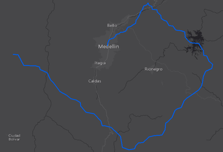

Depending on the amount of data you have you should either choose doing this manually in an edit session as Dan suggests of doing this with some python. To give you some additional help on using the Python option see the script below:
<SPAN class="keyword token">def</SPAN> <SPAN class="token function">main</SPAN><SPAN class="punctuation token">(</SPAN><SPAN class="punctuation token">)</SPAN><SPAN class="punctuation token">:</SPAN> <SPAN class="keyword token">import</SPAN> random <SPAN class="keyword token">import</SPAN> arcpy <SPAN class="comment token"># settings input and output data</SPAN> tbl <SPAN class="operator token">=</SPAN> r<SPAN class="string token">'C:\GeoNet\BearingDistance\data.gdb\BrearingDistanceData'</SPAN> fld_bear <SPAN class="operator token">=</SPAN> <SPAN class="string token">'Bearing'</SPAN> fld_dist <SPAN class="operator token">=</SPAN> <SPAN class="string token">'Distance'</SPAN> fc_out <SPAN class="operator token">=</SPAN> r<SPAN class="string token">'C:\GeoNet\BearingDistance\data.gdb\BrearingDistanceLine'</SPAN> <SPAN class="comment token"># start point and projected coordinate system</SPAN> start_x <SPAN class="operator token">=</SPAN> <SPAN class="operator token">-</SPAN><SPAN class="number token">8413550</SPAN> start_y <SPAN class="operator token">=</SPAN> <SPAN class="number token">696897</SPAN> sr <SPAN class="operator token">=</SPAN> arcpy<SPAN class="punctuation token">.</SPAN>SpatialReference<SPAN class="punctuation token">(</SPAN><SPAN class="number token">3857</SPAN><SPAN class="punctuation token">)</SPAN> <SPAN class="comment token"># create start point</SPAN> pntg <SPAN class="operator token">=</SPAN> arcpy<SPAN class="punctuation token">.</SPAN>PointGeometry<SPAN class="punctuation token">(</SPAN>arcpy<SPAN class="punctuation token">.</SPAN>Point<SPAN class="punctuation token">(</SPAN>start_x<SPAN class="punctuation token">,</SPAN> start_y<SPAN class="punctuation token">)</SPAN><SPAN class="punctuation token">,</SPAN> sr<SPAN class="punctuation token">)</SPAN> <SPAN class="comment token"># create sequential points</SPAN> points <SPAN class="operator token">=</SPAN> <SPAN class="punctuation token">[</SPAN>pntg<SPAN class="punctuation token">.</SPAN>firstPoint<SPAN class="punctuation token">]</SPAN> pntg_prev <SPAN class="operator token">=</SPAN> pntg <SPAN class="keyword token">with</SPAN> arcpy<SPAN class="punctuation token">.</SPAN>da<SPAN class="punctuation token">.</SPAN>SearchCursor<SPAN class="punctuation token">(</SPAN>tbl<SPAN class="punctuation token">,</SPAN> <SPAN class="punctuation token">(</SPAN>fld_bear<SPAN class="punctuation token">,</SPAN> fld_dist<SPAN class="punctuation token">)</SPAN><SPAN class="punctuation token">)</SPAN> <SPAN class="keyword token">as</SPAN> curs<SPAN class="punctuation token">:</SPAN> <SPAN class="keyword token">for</SPAN> row <SPAN class="keyword token">in</SPAN> curs<SPAN class="punctuation token">:</SPAN> angle <SPAN class="operator token">=</SPAN> row<SPAN class="punctuation token">[</SPAN><SPAN class="number token">0</SPAN><SPAN class="punctuation token">]</SPAN> distance <SPAN class="operator token">=</SPAN> row<SPAN class="punctuation token">[</SPAN><SPAN class="number token">1</SPAN><SPAN class="punctuation token">]</SPAN> pntg_new <SPAN class="operator token">=</SPAN> pntg_prev<SPAN class="punctuation token">.</SPAN>pointFromAngleAndDistance<SPAN class="punctuation token">(</SPAN>angle<SPAN class="punctuation token">,</SPAN> distance<SPAN class="punctuation token">)</SPAN> pntg_prev <SPAN class="operator token">=</SPAN> pntg_new points<SPAN class="punctuation token">.</SPAN>append<SPAN class="punctuation token">(</SPAN>pntg_new<SPAN class="punctuation token">.</SPAN>firstPoint<SPAN class="punctuation token">)</SPAN> <SPAN class="comment token"># create polyline and store result</SPAN> polyline <SPAN class="operator token">=</SPAN> arcpy<SPAN class="punctuation token">.</SPAN>Polyline<SPAN class="punctuation token">(</SPAN>arcpy<SPAN class="punctuation token">.</SPAN>Array<SPAN class="punctuation token">(</SPAN>points<SPAN class="punctuation token">)</SPAN><SPAN class="punctuation token">,</SPAN> sr<SPAN class="punctuation token">)</SPAN> arcpy<SPAN class="punctuation token">.</SPAN>CopyFeatures_management<SPAN class="punctuation token">(</SPAN><SPAN class="punctuation token">[</SPAN>polyline<SPAN class="punctuation token">]</SPAN><SPAN class="punctuation token">,</SPAN> fc_out<SPAN class="punctuation token">)</SPAN> <SPAN class="keyword token">if</SPAN> __name__ <SPAN class="operator token">==</SPAN> <SPAN class="string token">'__main__'</SPAN><SPAN class="punctuation token">:</SPAN> main<SPAN class="punctuation token">(</SPAN><SPAN class="punctuation token">)</SPAN><SPAN class="line-numbers-rows"><SPAN></SPAN><SPAN></SPAN><SPAN></SPAN><SPAN></SPAN><SPAN></SPAN><SPAN></SPAN><SPAN></SPAN><SPAN></SPAN><SPAN></SPAN><SPAN></SPAN><SPAN></SPAN><SPAN></SPAN><SPAN></SPAN><SPAN></SPAN><SPAN></SPAN><SPAN></SPAN><SPAN></SPAN><SPAN></SPAN><SPAN></SPAN><SPAN></SPAN><SPAN></SPAN><SPAN></SPAN><SPAN></SPAN><SPAN></SPAN><SPAN></SPAN><SPAN></SPAN><SPAN></SPAN><SPAN></SPAN><SPAN></SPAN><SPAN></SPAN><SPAN></SPAN><SPAN></SPAN><SPAN></SPAN><SPAN></SPAN><SPAN></SPAN></SPAN>
It takes a table with two fields (Bearing and Distance, see settings on line 7 and 😎 and an initial point (see lines 12 and 13) and traces a line. See the result below:
To create the table data I used a random function. See code below:
<SPAN class="keyword token">def</SPAN> <SPAN class="token function">main</SPAN><SPAN class="punctuation token">(</SPAN><SPAN class="punctuation token">)</SPAN><SPAN class="punctuation token">:</SPAN> <SPAN class="keyword token">import</SPAN> random <SPAN class="keyword token">import</SPAN> arcpy tbl <SPAN class="operator token">=</SPAN> r<SPAN class="string token">'C:\GeoNet\BearingDistance\data.gdb\BrearingDistanceData'</SPAN> fld_bear <SPAN class="operator token">=</SPAN> <SPAN class="string token">'Bearing'</SPAN> fld_dist <SPAN class="operator token">=</SPAN> <SPAN class="string token">'Distance'</SPAN> <SPAN class="keyword token">with</SPAN> arcpy<SPAN class="punctuation token">.</SPAN>da<SPAN class="punctuation token">.</SPAN>InsertCursor<SPAN class="punctuation token">(</SPAN>tbl<SPAN class="punctuation token">,</SPAN> <SPAN class="punctuation token">(</SPAN>fld_bear<SPAN class="punctuation token">,</SPAN> fld_dist<SPAN class="punctuation token">)</SPAN><SPAN class="punctuation token">)</SPAN> <SPAN class="keyword token">as</SPAN> curs<SPAN class="punctuation token">:</SPAN> <SPAN class="keyword token">for</SPAN> i <SPAN class="keyword token">in</SPAN> range<SPAN class="punctuation token">(</SPAN><SPAN class="number token">100</SPAN><SPAN class="punctuation token">)</SPAN><SPAN class="punctuation token">:</SPAN> sector <SPAN class="operator token">=</SPAN> divmod<SPAN class="punctuation token">(</SPAN>i<SPAN class="punctuation token">,</SPAN> <SPAN class="number token">25</SPAN><SPAN class="punctuation token">)</SPAN><SPAN class="punctuation token">[</SPAN><SPAN class="number token">0</SPAN><SPAN class="punctuation token">]</SPAN> <SPAN class="comment token"># 0 to 3</SPAN> angle <SPAN class="operator token">=</SPAN> random<SPAN class="punctuation token">.</SPAN>randrange<SPAN class="punctuation token">(</SPAN>sector <SPAN class="operator token">*</SPAN> <SPAN class="number token">90</SPAN><SPAN class="punctuation token">,</SPAN> <SPAN class="punctuation token">(</SPAN>sector<SPAN class="operator token">+</SPAN><SPAN class="number token">1</SPAN><SPAN class="punctuation token">)</SPAN><SPAN class="operator token">*</SPAN><SPAN class="number token">90</SPAN><SPAN class="punctuation token">)</SPAN> distance <SPAN class="operator token">=</SPAN> random<SPAN class="punctuation token">.</SPAN>randrange<SPAN class="punctuation token">(</SPAN><SPAN class="number token">1000</SPAN><SPAN class="punctuation token">,</SPAN> <SPAN class="number token">1050</SPAN><SPAN class="operator token">+</SPAN>i<SPAN class="operator token">*</SPAN><SPAN class="number token">50</SPAN><SPAN class="punctuation token">)</SPAN> <SPAN class="keyword token">print</SPAN> i<SPAN class="punctuation token">,</SPAN> sector<SPAN class="punctuation token">,</SPAN> angle<SPAN class="punctuation token">,</SPAN> distance curs<SPAN class="punctuation token">.</SPAN>insertRow<SPAN class="punctuation token">(</SPAN><SPAN class="punctuation token">(</SPAN>angle<SPAN class="punctuation token">,</SPAN> distance<SPAN class="punctuation token">,</SPAN> <SPAN class="punctuation token">)</SPAN><SPAN class="punctuation token">)</SPAN> <SPAN class="keyword token">if</SPAN> __name__ <SPAN class="operator token">==</SPAN> <SPAN class="string token">'__main__'</SPAN><SPAN class="punctuation token">:</SPAN> main<SPAN class="punctuation token">(</SPAN><SPAN class="punctuation token">)</SPAN> <SPAN class="line-numbers-rows"><SPAN></SPAN><SPAN></SPAN><SPAN></SPAN><SPAN></SPAN><SPAN></SPAN><SPAN></SPAN><SPAN></SPAN><SPAN></SPAN><SPAN></SPAN><SPAN></SPAN><SPAN></SPAN><SPAN></SPAN><SPAN></SPAN><SPAN></SPAN><SPAN></SPAN><SPAN></SPAN><SPAN></SPAN></SPAN>
