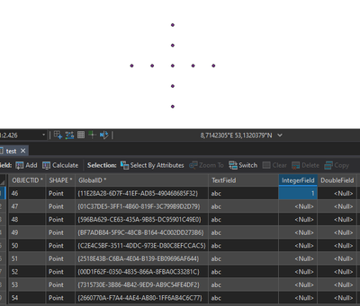

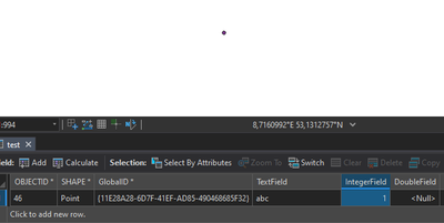

Before
After (note that I only specified "TextField" to be copied)

Before
