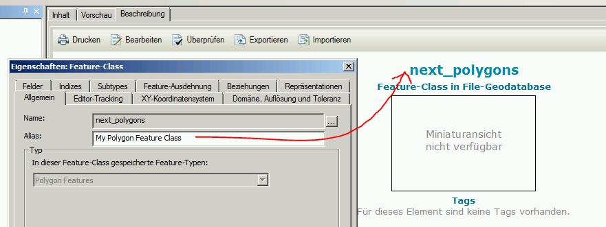

How to populate metadata title from alias name of feature class?
2175
01-02-2018 08:02 AM
StefanOffermann
Deactivated User
I have a SDE with a lot of feature classes. I want to populate the metadata of the feature classes mostly automatic. Can I update the metadata title of all feature classes by using the alias name of the feature class? I have used the geoprocessing tool "Synchronize Metadata", it is useful for bounding box, spatial reference, etc. but it wont update the metadata title.

So I made a python script for automatic updates of all feature classes in a geodatabase (also in feature datasets), my be this is helpful to others.
