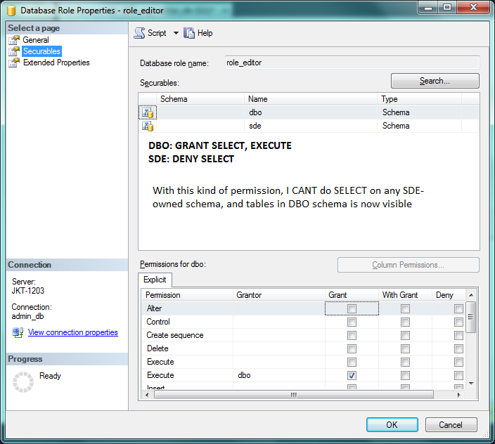

I create a new login "dbadmin" with Server Role : Public, Diskadmin, securityadmin,sysadmin, serveradmin and dbcreator
I already have a geodatabase with the system table under schema SDE. and also i have some tables under DBO schema
With this dbadmin, i create a Database Role: role_editor, and also i create user named "user_editor". User_editor is member of role_editor
In the Database Role property for role_editor, i specify permission for dbo: SELECT,INSERT,ALTER,EXECUTE,DELETE and UPDATE. For sde, i do not specify any permissions.
Question is:
1. when i log on as user_editor, I can see all tables in SDE schema. I can do "select * from sde.tabelxxx" too. Why ? Should SDE tables be hidden ?
2. Then I change the permission of sde in Database Role role_editor so that the SELECT is DENY. Then I cant do SELECT. Why should I specify DENY SELECT for SDE schema ? Shouldnt SELECT is automatically denied since i do not state the permission on SDE schema ?
3. Shouldnt it the other way around, i should specify permission in the Database Role for SDE schema instead of DBO ?
[Database: SQL Server 2012, ArcSDE 10.1]
Thanks

HaniuHokkaido
Deactivated User
I agree with you Vince. And i do not intend to give permission to view SDE schema, this is just a mere test.
I do not want this user_editor to see tables in SDE schema.
Why these tables in SDE schema are visible to user_editor, whereas the DBO tables are not visible ?
Why do i have to set schema permission in Database Role explicitly for DBO, by GRANT SELECT,EXECUTE, so that all tables are visible and I have to DENY SELECT for SDE schema so that this user_editor cant execute SELECT ? Shouldnt it be the other way around, i have to GRAND SELECT on SDE just to be able to see / SELECT SDE-owned tables ?
user_editor and role_editor are created by myself, not RDBMS's default
thanks
VinceAngelo
Esri Esteemed Contributor
Users must have access to the contents of SDE system tables for ArcGIS to work.  The PUBLIC pseudo-role is granted SELECT access to make this possible.  You cannot remove SELECT access from SDE tables and retain geodatabase functionality.  I recommend RDBMS documentation for details on available security model features, but counsel caution on the use of more exotic features -- If I don't want a user having access to SDE tables, I don't give them a login.
- V
HaniuHokkaido
Deactivated User
Hi Vince,
So the SDE schema must be accessible to have geodatabse functionality. thats why the SDE tables are all visible.
Allright. I get it.. thanks for the answer Vince...
