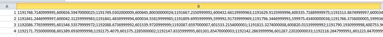

Thank you for your help Xander, it's worked. But the result of a test run i get not like my wish
example: the coordinates of polygon i use is a GCS_WGS_1984 and the result show me like this
but the file result i want to receive like below :
the type coordinates is Degree same like coordinates of Google earth file
Could you please help me change a little bit of the code and then export the coordinates like i hope
thank you very much Xander....
XanderBakker
Esri Esteemed Contributor
I guess that if you project your coordinates to WGS 1984, the result will list the coordinates in WGS 1984 decimal degrees. The code will not change the coordinates, just make sure your shapefile or featureclass is in the right coordinate system before you run the code.
