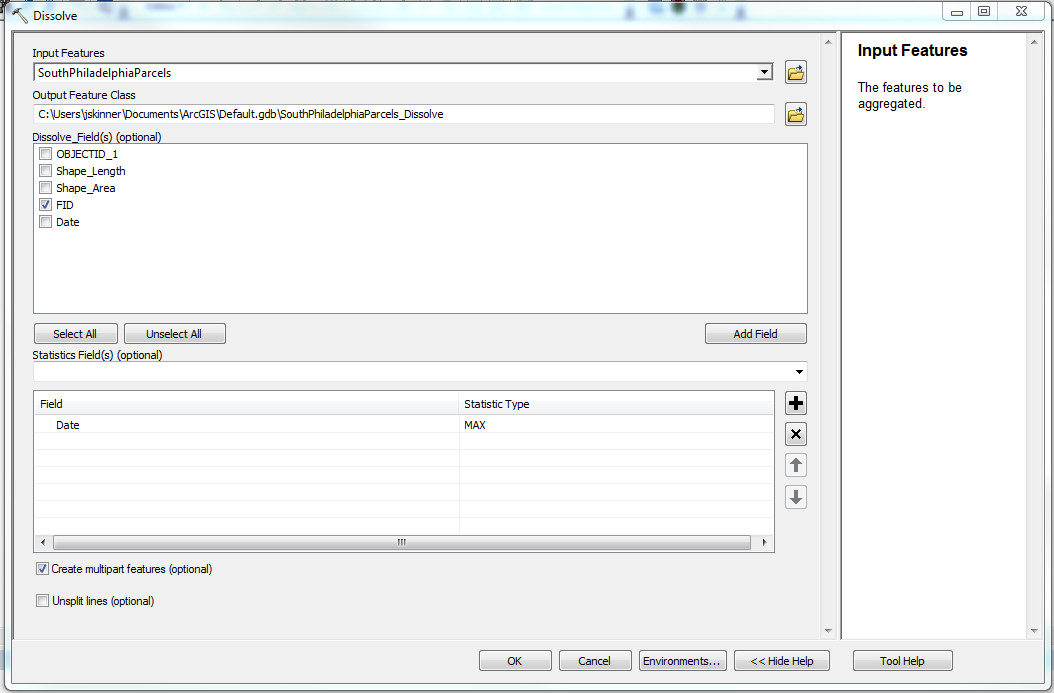

Hi Robert,
If all of the attributes are contained with the property leases feature class, you can run a Dissolve.  You will want to specify the FID field to dissolve on and the Date field as a MAX statistic.  Ex:
RobertParty
Deactivated User
Is there a way to do this but to keep the other fields with the data? this is working to get the FIDs that I need but then I lose the Owner of the lease.
DarrenWiens2
MVP Alum
Dissolve by both Owner and FID. This will merge together all unique combinations of Owner and FID.
