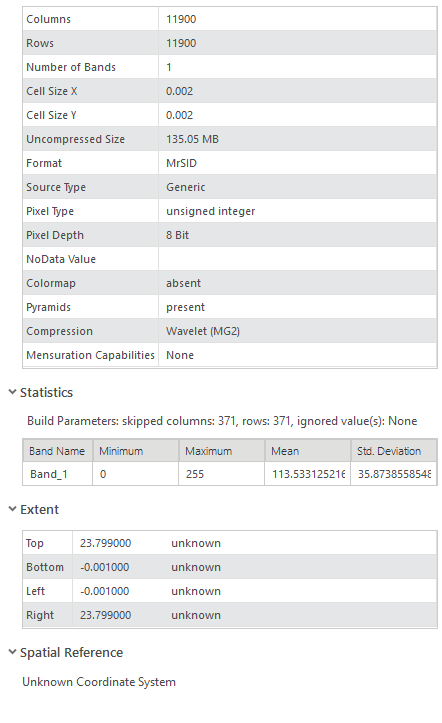

Hi Timothy, thanks for the reply.  There is no Spatial Reference for the sid files. Here is a screenshot of the metadataimgDetails.PNG

Ok, then you will need to convert it to another format as Dan mentioned. Keep in mind that SID files are highly compressed, and the storage for the new file will be significantly greater. In the example above it's only 135mb uncompressed so that's not bad, but keep an eye on this for other rasters.
