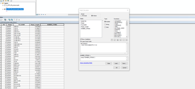

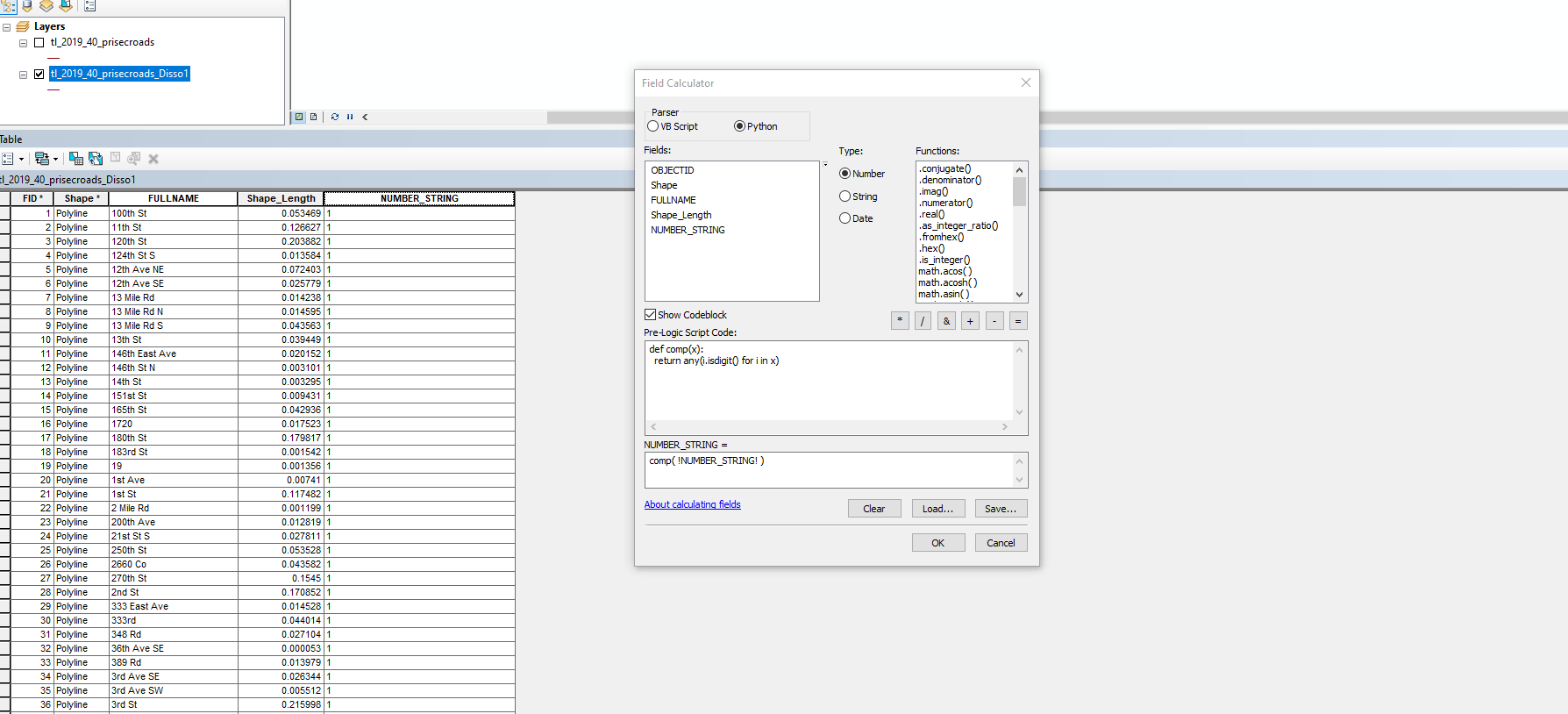

I am trying to Field Calc the integers that live in a STRING field for roads. The client only wants the numbers of each road and not any of the text. I have tried : def comp(x):
return any(i.isdigit() for i in x)
No real results. This finds a number and returns "1" if true and "0" if false. What I need is for the entire number, say 100th Street, would become 100. Any help would be much appreciated.
Sincerely,
Jeremiah McDonald
