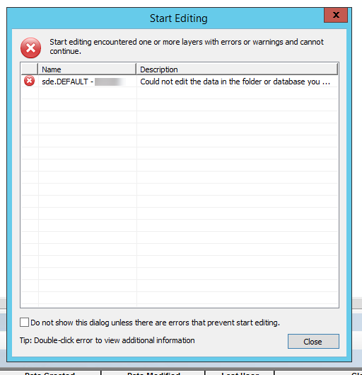

I created a Pipeline Referencing Feature dataset, and inside it is created a Point Feature class, I did that using ArcGIS Pro. when I try to access the information from ArcMap, I am able to load the information, its attributes everything, but I am not able to perform edits:
I am using the same credentials to connect to the geodatabase.

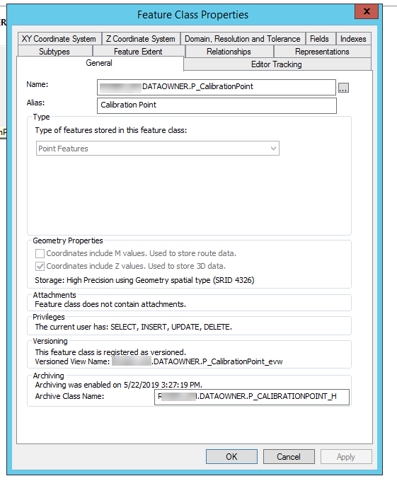

According to ArcCatalog, this are the permissions:
What I am missing here?

Are you trying to perform the editing in ArcMap using the same user as ArcGIS Pro? Can you connect as DATAOWNER and check.
Cristian_Galindo
I just try, I cannot do any edit
Cristian_Galindo
Yes, I was using the same user. I try unsing the DataOwner user, but the result was the same
