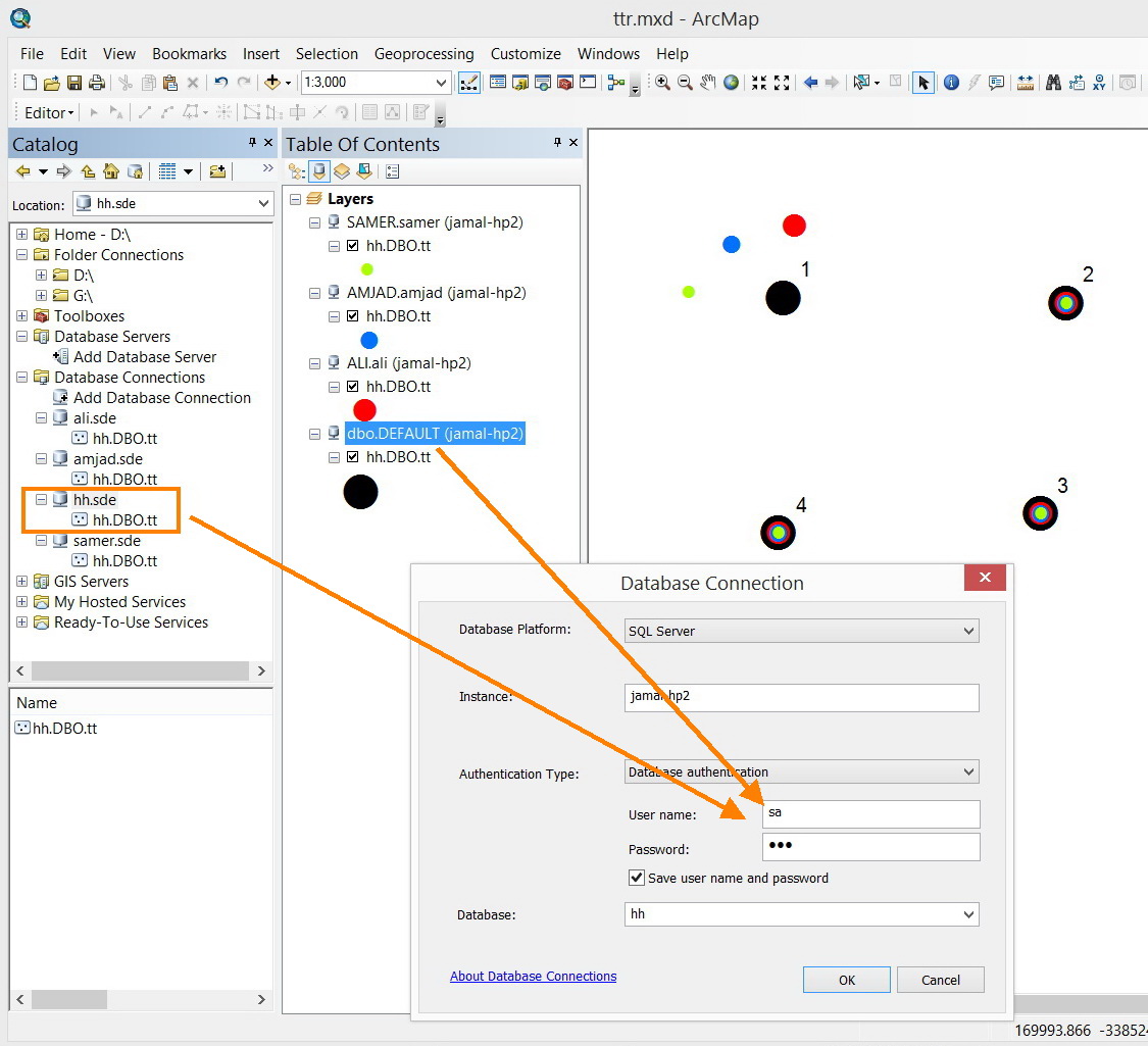

In the screenshots below, three child versions are taken from the parent version (default).

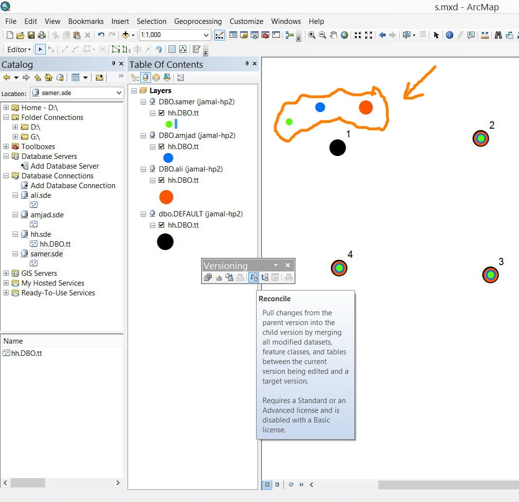

Same feature is edited in the three child versions.

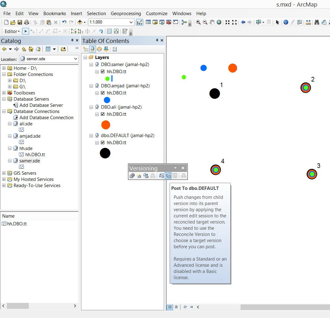

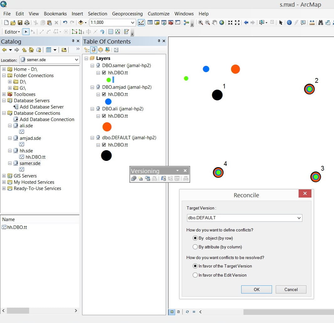

Changes in the child versions are detected and “Reconcile” is applied

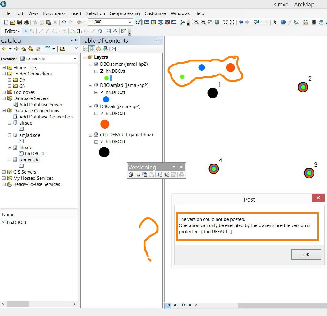

“Post” has introduced the message below
Then how the changes in the child versions can be posted to the parent?
Does the ArcGIS detect the conflicts between the child versions?
Does the ArcGIS resolve the conflicts between the child versions and then resolve them with the parent?

Since the version the DEFAULT version is protected, you must connect to the geodatabase as a user with DBO privileges to perform the post.  If there are conflicts found, you will be prompted to resolve the conflicts.
AsrujitSengupta
Deactivated User

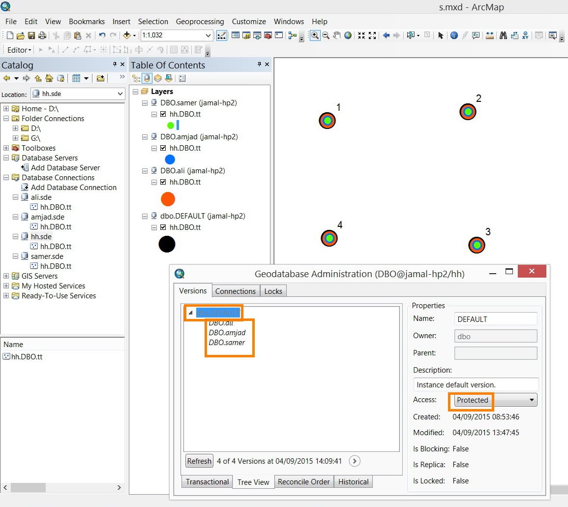

The error that you are observing during Post is indicating that you may not be connected as a DBO user. The DEFAULT version has an Access level of 'Protected' and thus only the version owner, DBO in this case can do the POST.
Conflict will only be detected if the same feature has been modified in both the versions, the Parent and the Child.
When you perform the Reconcile for the first Child version, no conflict should be detected, because the feature was not modified in the DEFAULT version, but was only modified in the Child version.
However, subsequent Reconciles for the other two child versions should detect a Conflict, and will let you choose in whose favour to resolve that Conflict.

Sure the default is accessed by the owner (sa) as shown in the screenshots below. Nevertheless, post fails to work.
What other issues should I consider?
