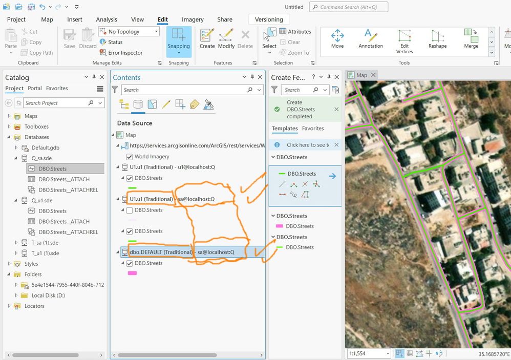

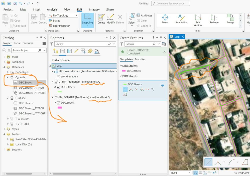

Follow the below workflow:
1. From the connection as 'sa' user> add the feature class into ArcMap
2. Change Version to the child version
3. Now start editing
4. Now do the Reconcile
You should get the conflict

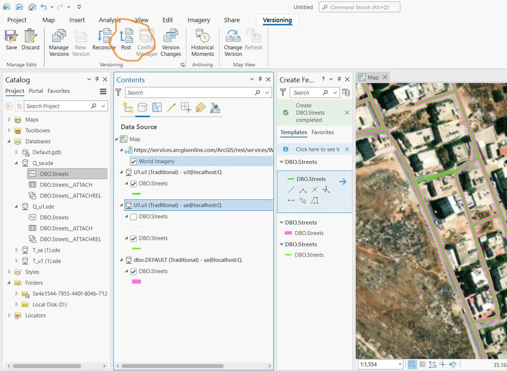

I’m not sure why this is the only scenario that works; I mean to firstly add the default version (with sa credentials) and then to switch it to a child version and next to apply the reconcile\post (in editing environment).
Jamal Numan
AsrujitSengupta
Deactivated User
It will work even when you connect with any 'sysadmin' login and connect to the child version to perform the Reconcile\Post.

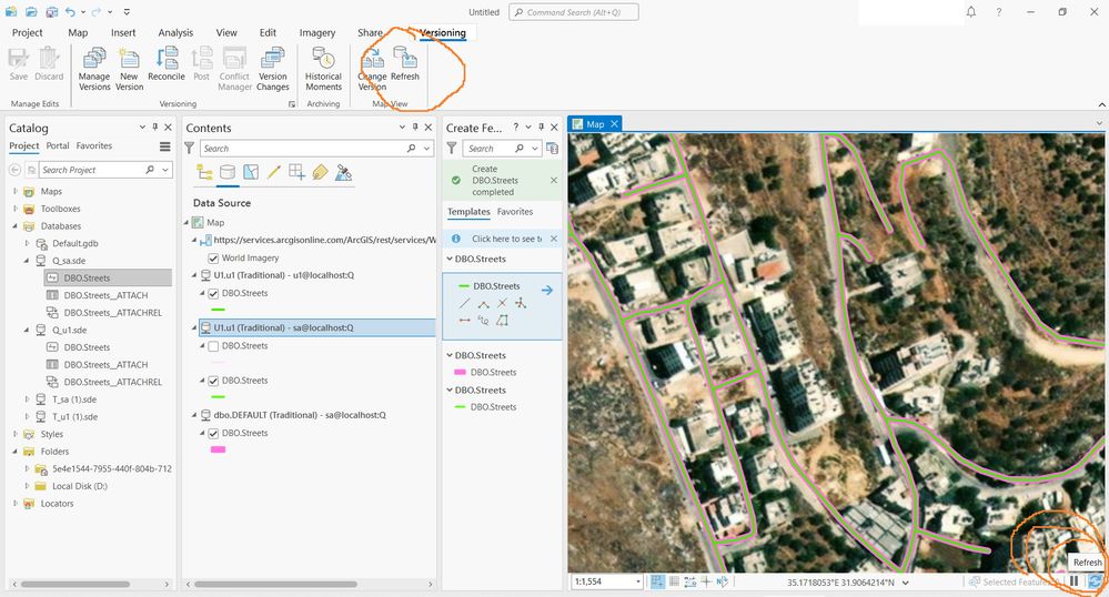

The good thing in Pro that the name of the user is displayed with the name of the version.

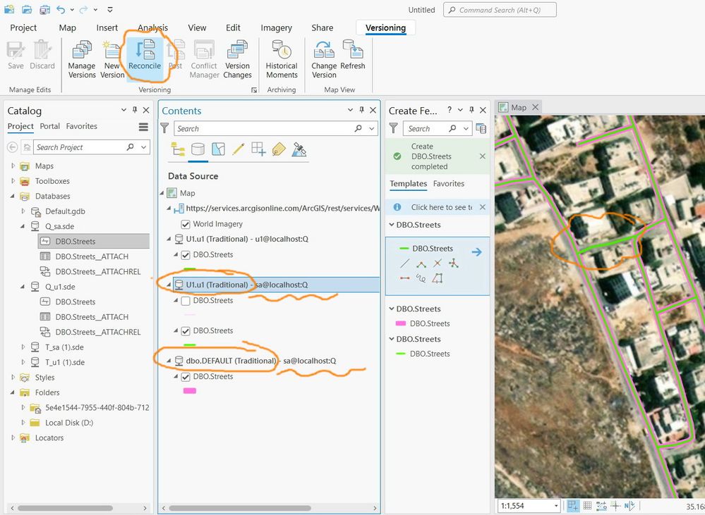

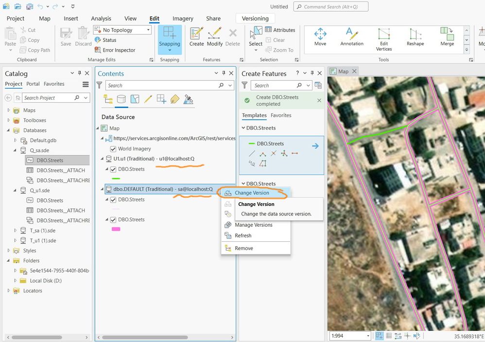

Both the parent and child versions are accessed with the sa user which makes it possible to post the edits from the child to the protected parent. The child is accessed by the sa by adding the layer by sa (as usual) but then switching the version to child
