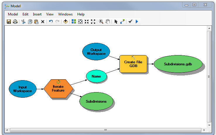

Just for fun I tested tested Chris Donohue, GISP ​suggestiion your model would look similar to the one in the graphic below. You will not need an in-line variable the iterate Feature tool output is available for use in the name for create File Geodatabase tool.

Wes, I think the model you set up needs one more step, a Copy Features tool to copy the input points to the newly created feature class.

Curtis Price ​is correct see below.

Curtis on the far right side I noted the precondition you may have to scroll to see it(see above). Thanks
