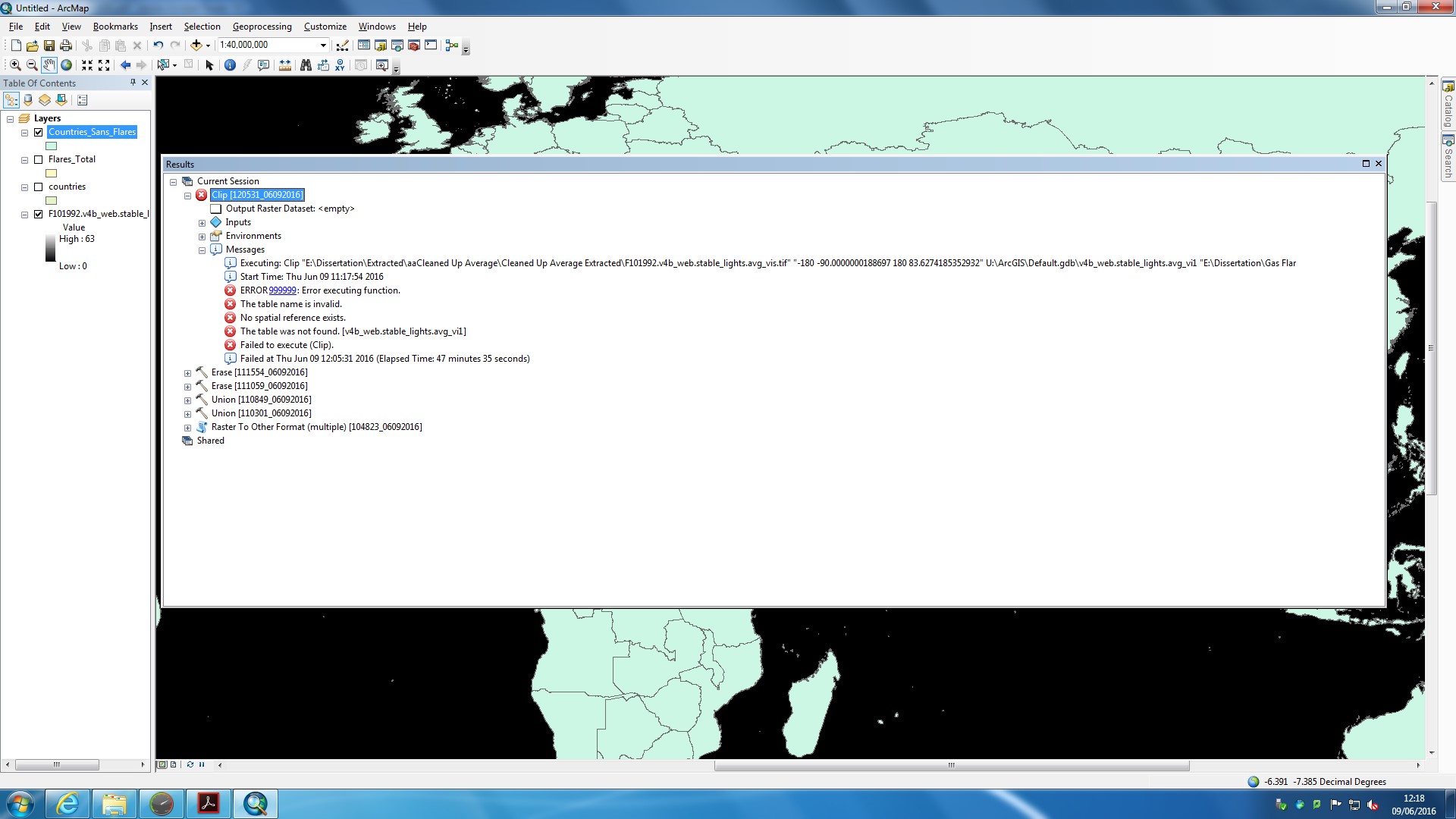

I'm new to using ArcMap and I'm trying to clip some light rasters but I get error messages that I don't understand. Does anyone have any ideas?Screen Grab.jpg

the output filenames are too long and contain spaces
you seem to be clipping the raster with the whole world
the file doing the clipping and/or the raster don't have a defined coordinate system
that's all I can see right now
