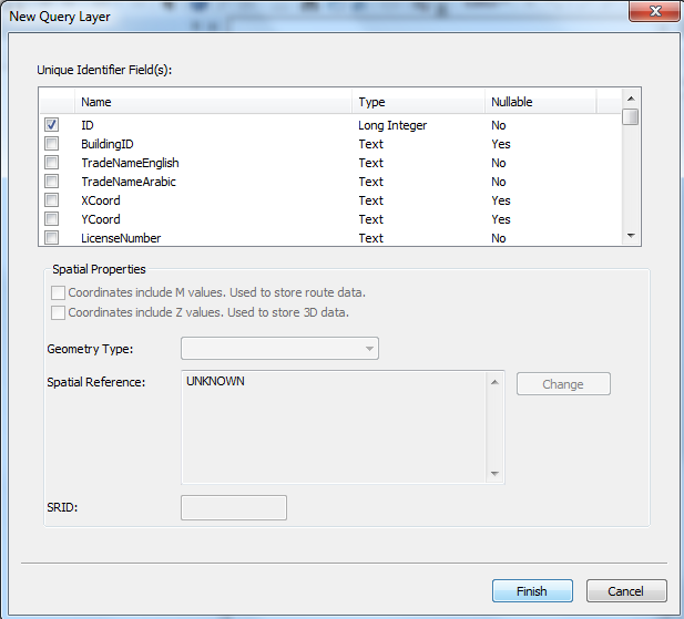

While I am dragging and dropping a view freshly created by the database administrator in a enterprise geodatabase hosted in MS SQL Server 2008 R2, in ArcMap 10.1, I am choosing the ID only:

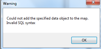

and I am getting the following error, that I cannot define:

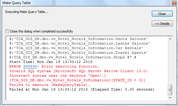

I have tried to access it through a "MakeQueryTable" process as well but I am getting the following error again:

- We have been creating a view, testing column by column and we made it work.
The issue was that many columns were containing NULL values through all the records and while dragging and dropping the view to ArcMap, it gave the error.
The trick is to replace the NULL values with ("") or spaces (" ") while created the view.
