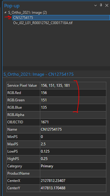

The tool should return the actual service pixel value when set to display visible layers, provided the source files are visible.  The screen shot below shows imagery from our published service it returns the same value for both the original image and the displayed files files.  Pyramids are only used for rendering and not data; however, do watch out for overview files.  These will be different and are identifiable in the Pop-up info.

Just to clarify, I'm working with a single geodatabase raster. Once I figured out I had to publish from Catalog - not as a map image layer - to be able to configure a popup, then I started seeing the Service Pixel Value you referred to.
Thanks for the reply and pointing me at the right words to search on to find what I needed.
