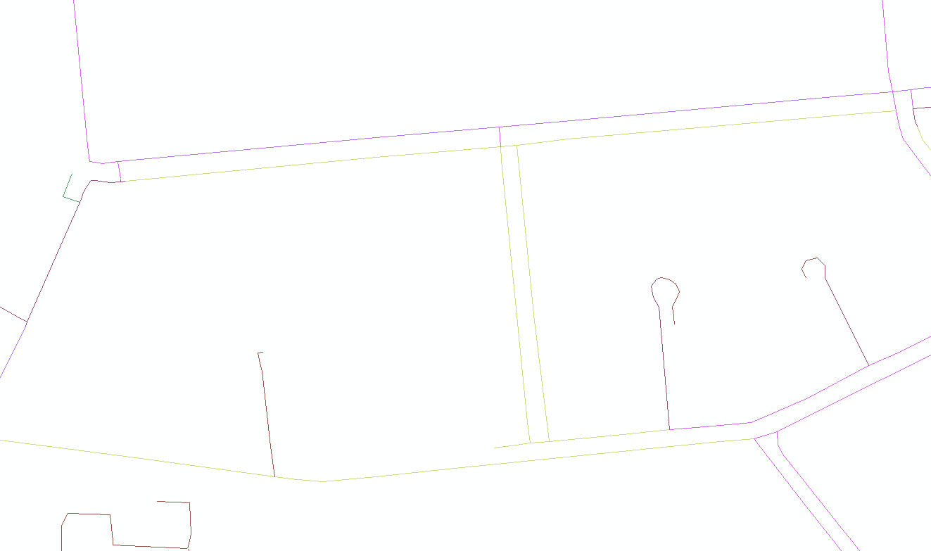

Dissolve seemed to be the tool for the job, but looking at the results, it's not doing what I need. First of all, it's not merging contiguous features that share the attributes specified in all cases, for example, in the image below the green lines all share the same material, diameter and pressure, but they remain as four separate features (the long horizontal at the top, the two vertical and the shorter horizontal at the bottom). It doesn't seem to make a difference if I select 'unsplit lines' or not.
The other issue is that the sum of repairs I get is for ALL features sharing those attributes, and is the same on each dissolved feature! E.g. each of the four features in the image below has the same sum, and I suspect even if I could get them to merge properly with the Dissolve tool then the single feature would also have that same total - which applies to the whole network and not just to the contiguous section.
