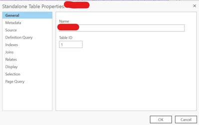

Braden_Miller
I'm trying to do the same thing, but there is no 'time' property available for the table.
There is a 'time' property for the GDB feature class, but the fields from the table are not included in the 'Time Field' drop down menu, despite having created a relationship class.
