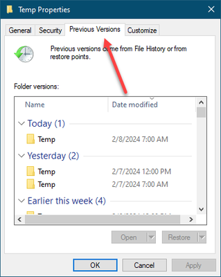

If system restore is enabled on the computer where the FGDB is stored, you may be able to find it in previous version tab.  Right click on the folder the FGDB is in, select 'Properties', then the Previous Versions tab.
Just copy one from right before the deletion.
