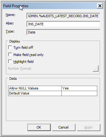

I am using ArcMap 10.5 with a table within our Enterprise SDE that has a join to a view (also in the SDE). This view has a date field that I would like to use to filter my data on. I need to find rows that were inspected in the past 90 days.
INS_DATE field properties:
An sample of my data:

I included a screenshot of my INS_DATE field, i do see it is a DATE type, is there any way it may not be storing dates?
I don't need to be exact with the 90 days, if I am within 24hr each side of that it will not matter for this particular job.

Also just looking at the INS_DATE field, I have confirmed it is of type 'DATE', but you will note the formatting within switches between date only, to datetime.
