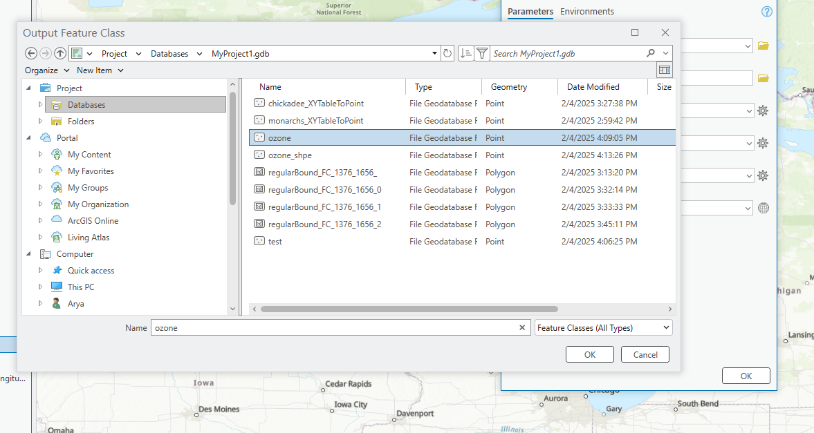

But if I change the output to be stored within the project, it works fine:
1 Reply
DavidPike
MVP Notable Contributor
It's most likely not the case of saving into a Project, rather that saving as s shapefile .shp has an error, where saving as a Feature Class inside a File Geodatabase .gdb does not.
There are several structural differences to .shp and .gdb Feature Classes such as field name lengths, .shp does not contain topologies, global IDs, only basic field types supported, a 2Gb file size limit, domains, subtypes not supported etc.
If I were to guess, you may either have a file over 2Gb, or a Date field (.shp does not store datetime in a  single field - only Date)
