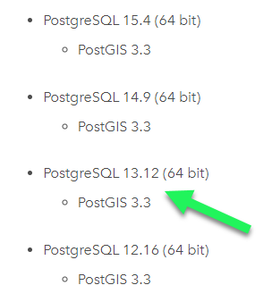

I am a little unclear about that list, I see
  • PostgreSQL 12.16 (64 bit)
    • PostGIS 3.3
as a minimum requirement?
but it's true that we haven't updated in a while.
George_Thompson
Esri Notable Contributor
Here are the min. versions for Pro 3.2.x:
Each major version of PostgreSQL (12, 13, 14, 15, etc..) are different from each other and have minor "updates" (.x) for each major version.
Herer is the link to the latest supported versions for windows: https://www.enterprisedb.com/downloads/postgres-postgresql-downloads
Hope that helps.
--- George T.
