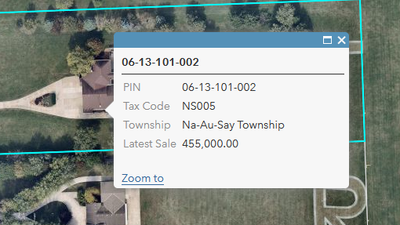

Here's how it looks in action:
Of course, there's no reason some of those functions couldn't be combined into one, but I kept them all separate for clarity.
