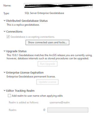

Cat_Boyes
Hi, not sure if this is helpful but here's some more info:
Database:
Feature Class:
