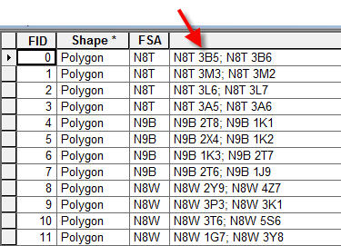

Hello,
I have a file that contains a field with multiple pieces of attribute data for one entry. The data in the field is separated by a semi-colon.
I need to create a separate polygon for each attribute in that field. Is this even a possibility, or am I going to have to copy each polygon multiple times and delete the attributes I don't want from each entry?
I hope this makes sense. See the attached image...
Basically I want the info in the second column, to be broken into each, individual code to have its own polygon.
Thanks
Larisa

No, it is just one polygon, (not a multipart polygon), with multiple pieces of data, seperated by semi colon. I am just not sure I am ready to manually create new polygons and attached data to them. I have an image I attached of what my attribute table looks like. So if we look at the first record (FID 0), you can see a column with N8T 3B5;N8T 3B6.... in this case I would need two polygons on top of each other, one with an attribute of N8T 3B5 and another with an attribute of N8T 3B6.
I am sure there is a model or script of something I can use to create such a beast...just can't wrap my head around how! lol!

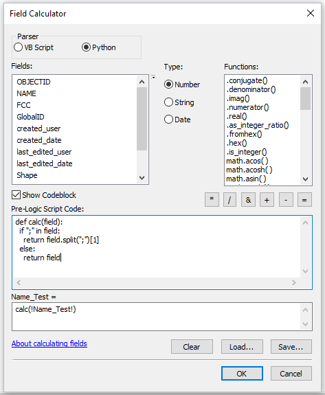

Here are steps you can try:
1.  Make a copy of the shapefile
2.  Open the original shapefile and run the following Field Calculation (replace Name_Test with the correct field name):
This will return the first value in the field.
3.  Run the Append tool and append the copied shapefile to the original shapefile
4.  Run the following Field Calculation:
This will return the second value in the field.
LarisaJohnstone
Thank you Dan and Jake!
 I figured it was a multistep process, I just could not get my head around how to start.
Thanks for the info. I am going to give it a try and get back to you!
