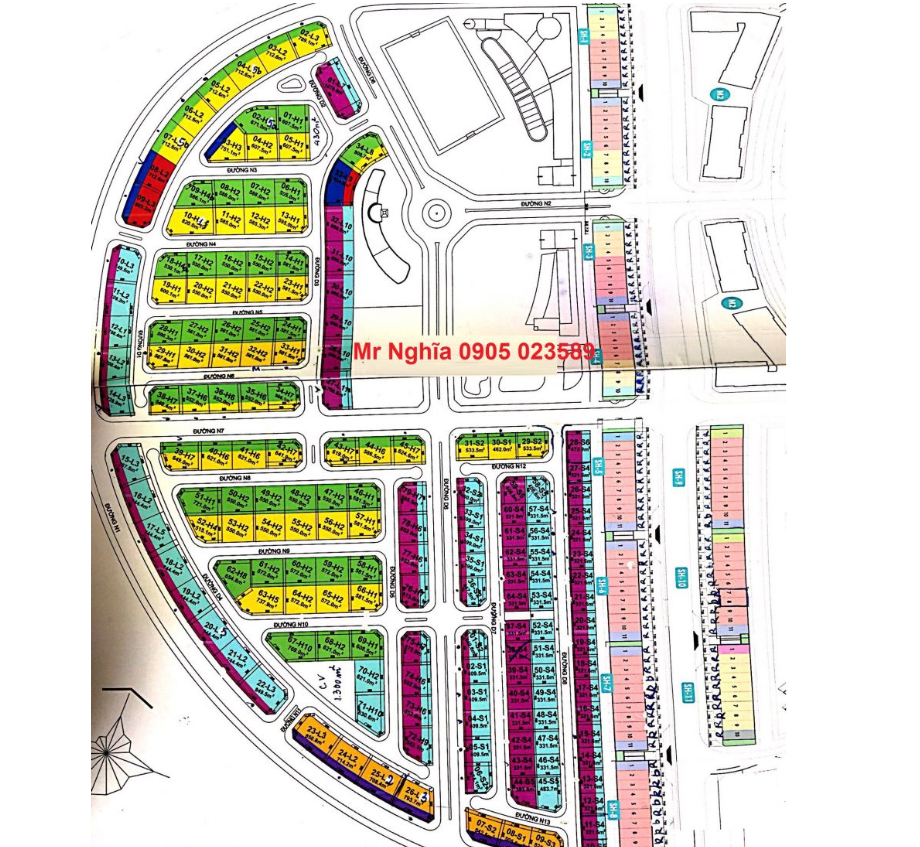

Based on the old results, my calculation is
- Create point of land plot
- Use near tool and Calculate the angle from the point just created to the road
- Use python code to switch from angle to direction ....

MRC
Sorry for the misunderstanding,
The data I just uploaded is the data that I manually made in the picture below and there is no use of any tool
They are for you to compare results according to your way
"""So which is it, is your workflow generating 90% accurate results or does it have "many" cases that are wrong? ""
My results are still accurate but it will be wrong in the case of road corners and complicated land plots
So i want to find out the best way to calculator exactly the result (about 90-95% )....
I can accept the error (about 80-90%) but I want to find out how to calculate the smallest error..
