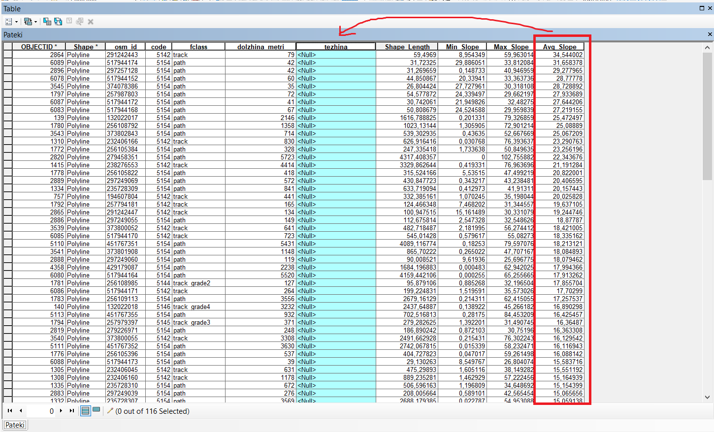

I am a beginner, I have no knowledge in coding and Python script but I need to do something that requires it.
I have an empty column which needs to be filled with three possible classes: easy, medium, difficult based on the values from another column.
So how to write the syntax in the Field Calculator where "easy" would contain values from 0-10, "medium" would contain values from 10-20 and "difficult" would contain values from 20-40 ?
JayantaPoddar
MVP Alum
As a beginner, you could just use Select by Attributes followed by Field Calculator (for the selected features).
Expression 1 (Select by Attributes)
"Avg_Slope" < 10
Expression 1 (Field Calculator)for tehzina
"Easy"
Expression 2 (Select by Attributes)
"Avg_Slope" >= 10 AND "Avg_Slope" < 20
Expression 2 (Field Calculator)for tehzina
"Medium"
Expression 3 (Select by Attributes)
"Avg_Slope" > 20
Expression 3 (Field Calculator)for tehzina
"Difficult"

PetarTraykov
Deactivated User
Thanks! I guess I've been focusing on codes and I've forgotten how simple it can be  I realized I could have just sorted the Avg Slopes by Ascending and select the desired rows and rename them with the Field Calc.
