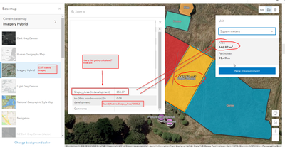

@DanPatterson I've read this post and another one you commented in about area calculations.
I am not an expert in projects or coordinate systems. That's probably why I have this question.
I created a layer in AGOL using the imagery hybrid as my basemap. It has auto-calculated the Shape_Area as it usually does. I then measured the polygon using the measuring tool, and the areas are way out. I'm not sure what coordinate system the basemap is, but going through all the options of measurements in the tool, I can't get one to match it.
Has anyone else had this problem? It's probably a stupid question, but I can't figure it out...
It's affecting my Ha calculation too. Ideally, I'd like the measurements in square meters and hectares.

Web Mercator coordinate system probably.  Seems that it surely isn't a sq ft vs m^2 thing
You shouldn't be doing area measurements unless you can set the coordinate system to be used to a better projected one or use geodesic calculations
